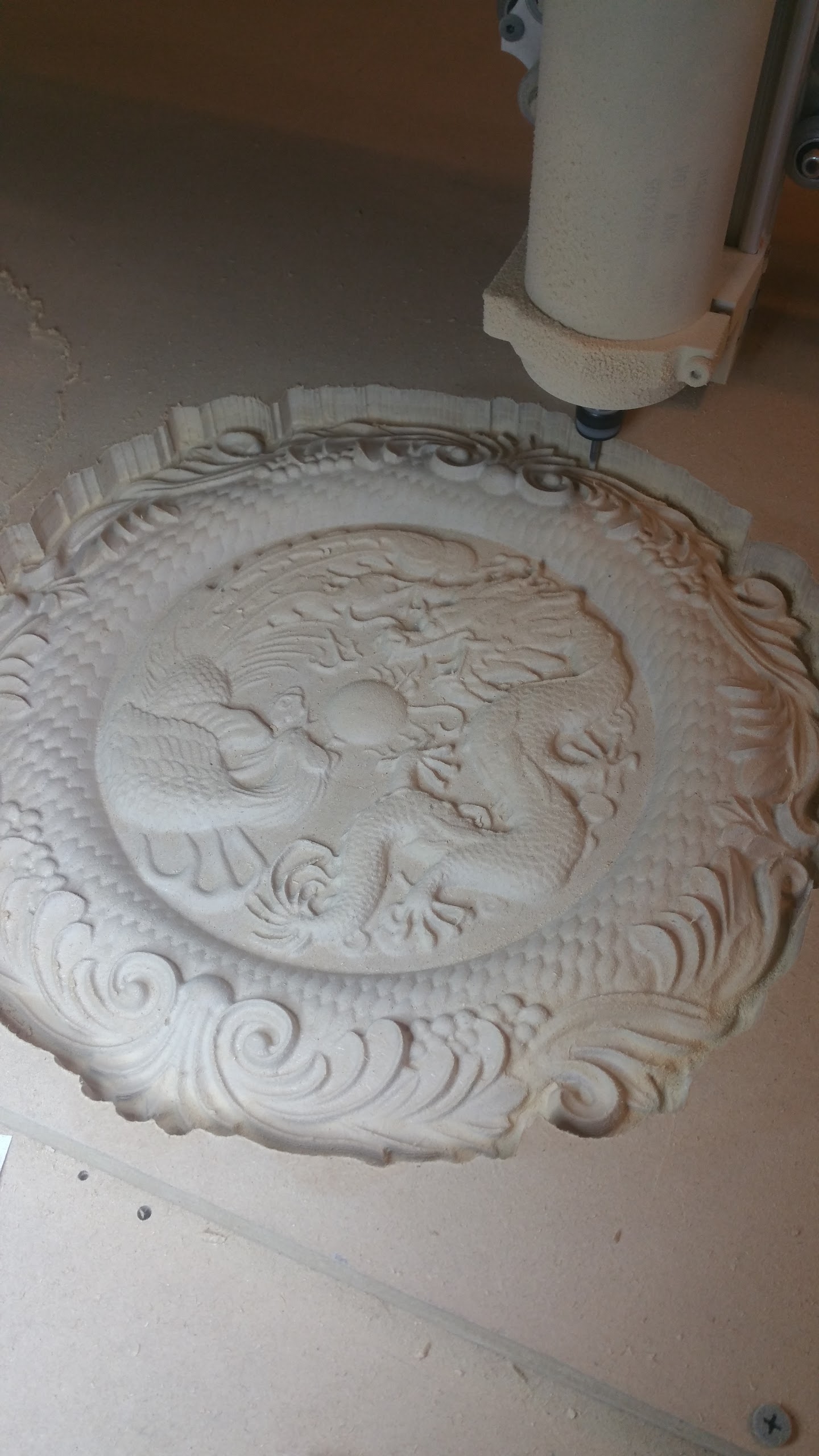

Well my second piece is almost completed. The learning curve was steep on this one as I have come to understand that chilipeppr is limited when it comes to handling very large gcode files(>10mb). So I failed at getting UGS configured properly but somehow I was able to get Universal Gcode Platform 64 to configure properly. Then there was a memory issue and I had to learn how to increase the heap memory in JAVA which is what UGP runs on.
This looks great. It’s amazing what we can make machines do. Great job.
Very cool. How long did that take?
Great job Rob you are killing bud. I don’t recall if CNC.js has a file size limit but may be another option.
