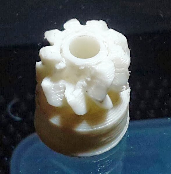

Well, that explains my uneven extrusion issues...
Well, that explains my uneven extrusion issues…
That’ll do it. :slight_smile: Hopefully you have a spare set of gears already but I suppose one could still limp along with that gear until its replacement is printed. Of course the best place to keep spare parts is in a complete spare 3d printer. :slight_smile: I wonder if there would be any benefit in making a double-wide set of gears that can handle twice the torque without breaking. Probably not, since I’ve got a huge number of hours on the very same part with my Prusa-Mendel. (looks worn but the two gears are nicely “familiarized” with each other and still strong) There must have been some kind of “interesting” event. :slight_smile:
This was caused by the combination of two factors – slic3r’s output being slightly hollow for gears, and the fact that my hobbed bolt has a wobbly head. The big gear wobbled quite a bit, and put axial forces on the small gear. I’m replacing that hobbed bolt with a hobbed pulley right now, so it will hopefully be less of a problem in the future!
