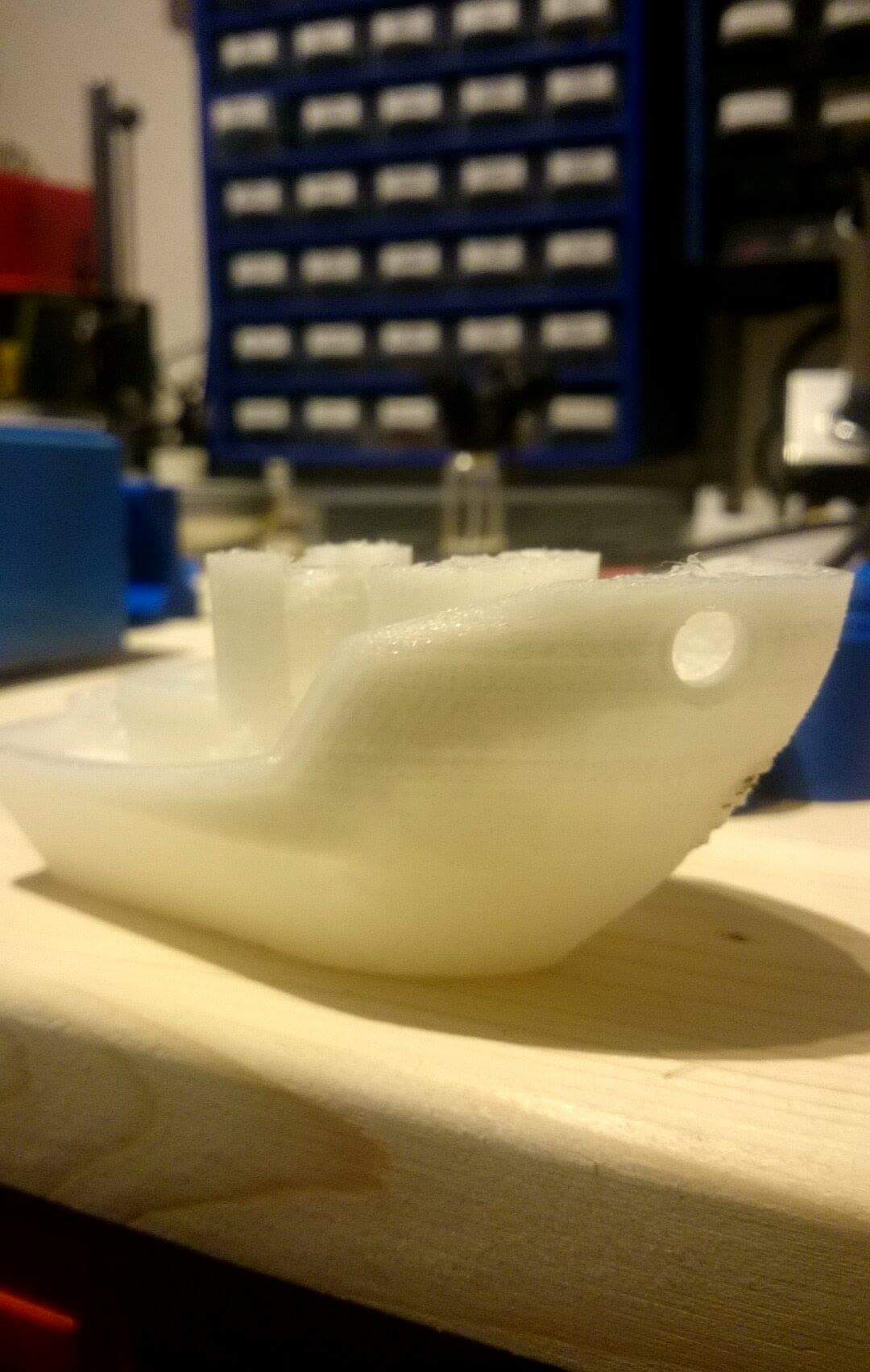

Well that sample if taulman 910 was a bit to short but Ive got
Well that sample if taulman 910 was a bit to short but Ive got it to stick at last. Nice now I can do technical printings in nylon yay
@Aric_Norine yes I had 645 because 910 wasnt on amazon but I sold it again because it warped like hell. 910 is not cheap. I have 3D Prima Nylon here which isnt that strong but it print fairly well
Care to share printing details?
@Daniel_Kruger ​ heatbed is pertiprint (from filafarm) @ 50deg, hotend first layer 270 remaining 250. No fan. 10mm/s first layer rest 50mm/s @ 0.6mm width from a 0.5mm nozzle
@VolksTrieb Thank you.
