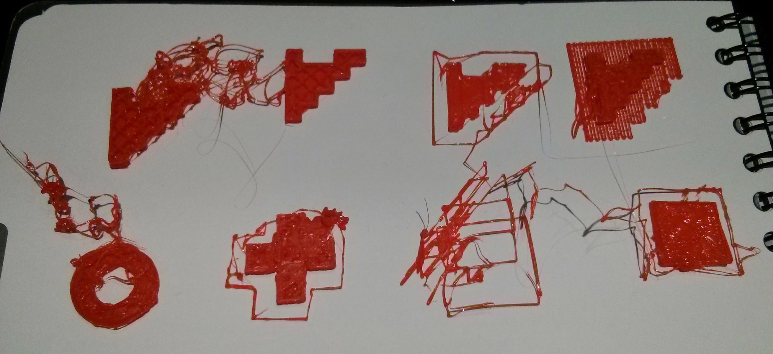

Well, that was a long fruitless day of printing. The one thing that broke the 4mm ceiling got to the lofty heights of 6.7mm before pulling away from the bed.
I haven’t kept/recorded/photographed the 10+ failed 20mm cubes that I used during belt tightening/loosening - they majority of which didn’t get past the 2nd layer.
Could it be the Arduino is fried? Even installed fresh firmware on that.
I keep seeing the prints go wrong about 6 mins in, this time shortens as I continue to print. The Y-motor also has a little jitter every 10 seconds after the failure.

Have you swapped motors / drivers with x axis to narrow down the source ?
I haven’t got to that point yet. I should mention that this is effectively a"plug-and-play" RepRap and my warranty will head in to the voided zone when that happens.
Unfamiliar with the terms and conditions there … but it seems to me either you have a warranty claim or the right to connect the x to y and y to x and see if the problems move with the motor or the axis.
Warrenty claim is where we’re going. I have spent enough time trying to solve it myself.
No all motors running at room temperature. Belts have moved from too tight to too loose and ended up at a happy medium.
