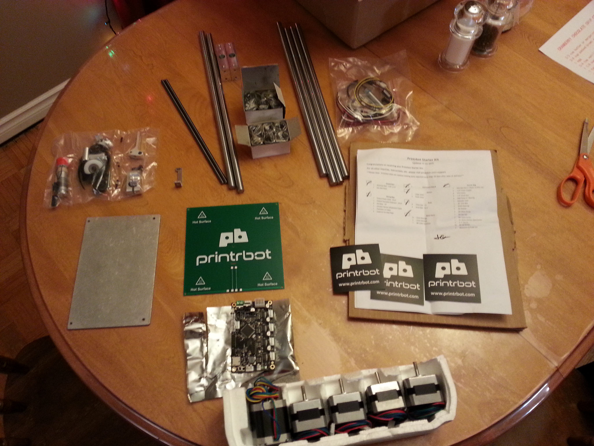

Well, the adventure begins - the brains,
Well, the adventure begins - the brains, nerves and muscles of the FrankenBot have arrived. Next up designing the skeleton…
Dumb question #1 (of probably many - LOL) - so, it appears to be 2 Z axis motor assemblies - but only one connector on the board and no Y-splitter for the cable. Make my own or is there some other trick? (and do we just trust that the two motors will stay in sync?)

You can find 4 pin molex connectors on eBay fairly cheap the last time I checked. And as for keeping them in sync, they should be fine unless one skips a step. I have been running mine like that for weeks now. Just used a y harness and it works great.
Nice quality kit. Love mine.
Very jealous you got the new hotend :-/ haha. Let me know how it works out or if you have questions. Happy to help.
@Griffin_Paquette Thanks for confirming that. I have lots of connectors in various junk bins to make the Y splitter. Just wanted to confirm that was the correct direction to head.
Yeah no prob! I’m a guy coming from a Ramps 1.4 so I wasn’t crazy about the idea of having to y off. But it really isn’t any different. Motors pull no power on most z axis anyways.
Remember, for current-controlled drivers, it is best to wire the motors in series.
Skipping steps, for electrical reasons, should then not be a problem.
