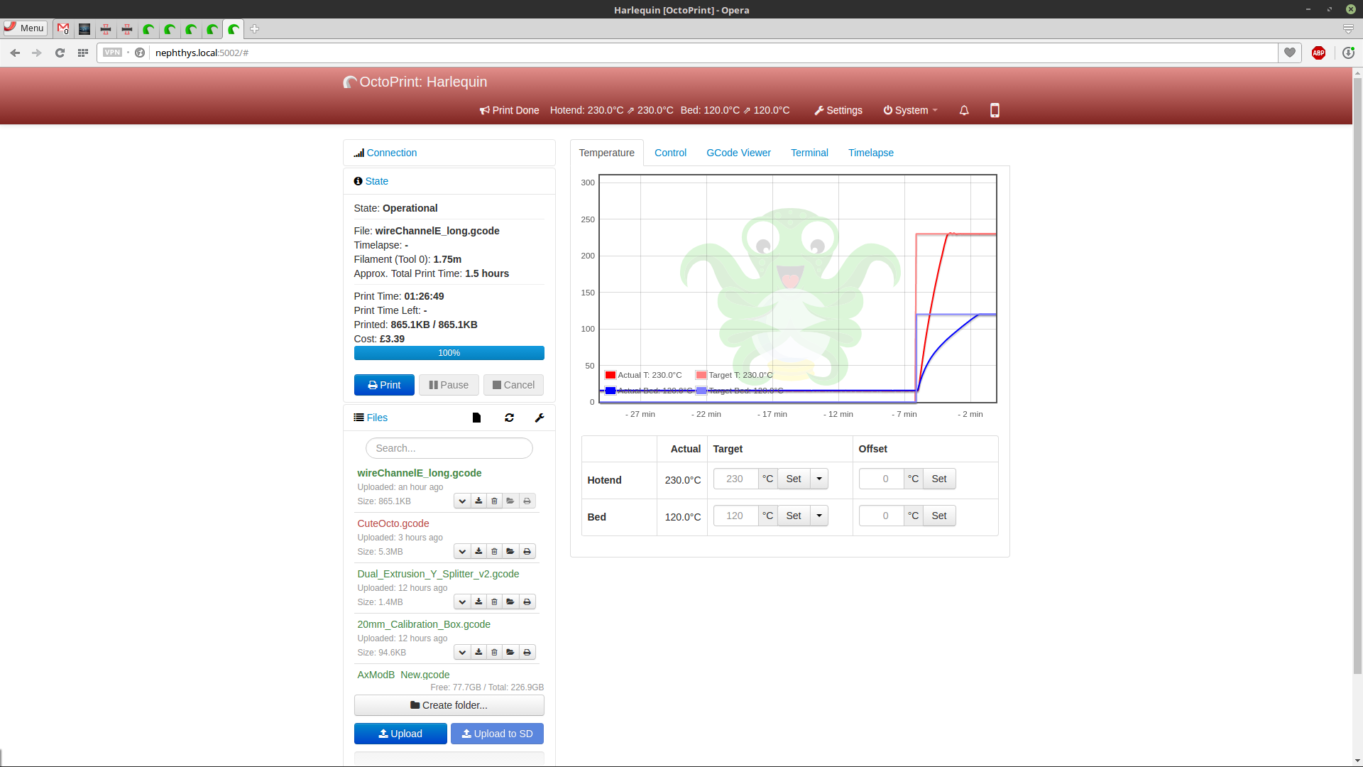

Well the Aluminium plate and 230v 200w Mains heater arrived for the newest FB2020.
Well the Aluminium plate and 230v 200w Mains heater arrived for the newest FB2020. Love these heat up times… awww yis… ~5 min to 120c on the bed and I’m pretty sure it’ll go higher. I’m only using the ally plate as a heat spreader, as I’m planning on putting PEI on top, it’s just that and getting the Re-ARM in and it’s done.
