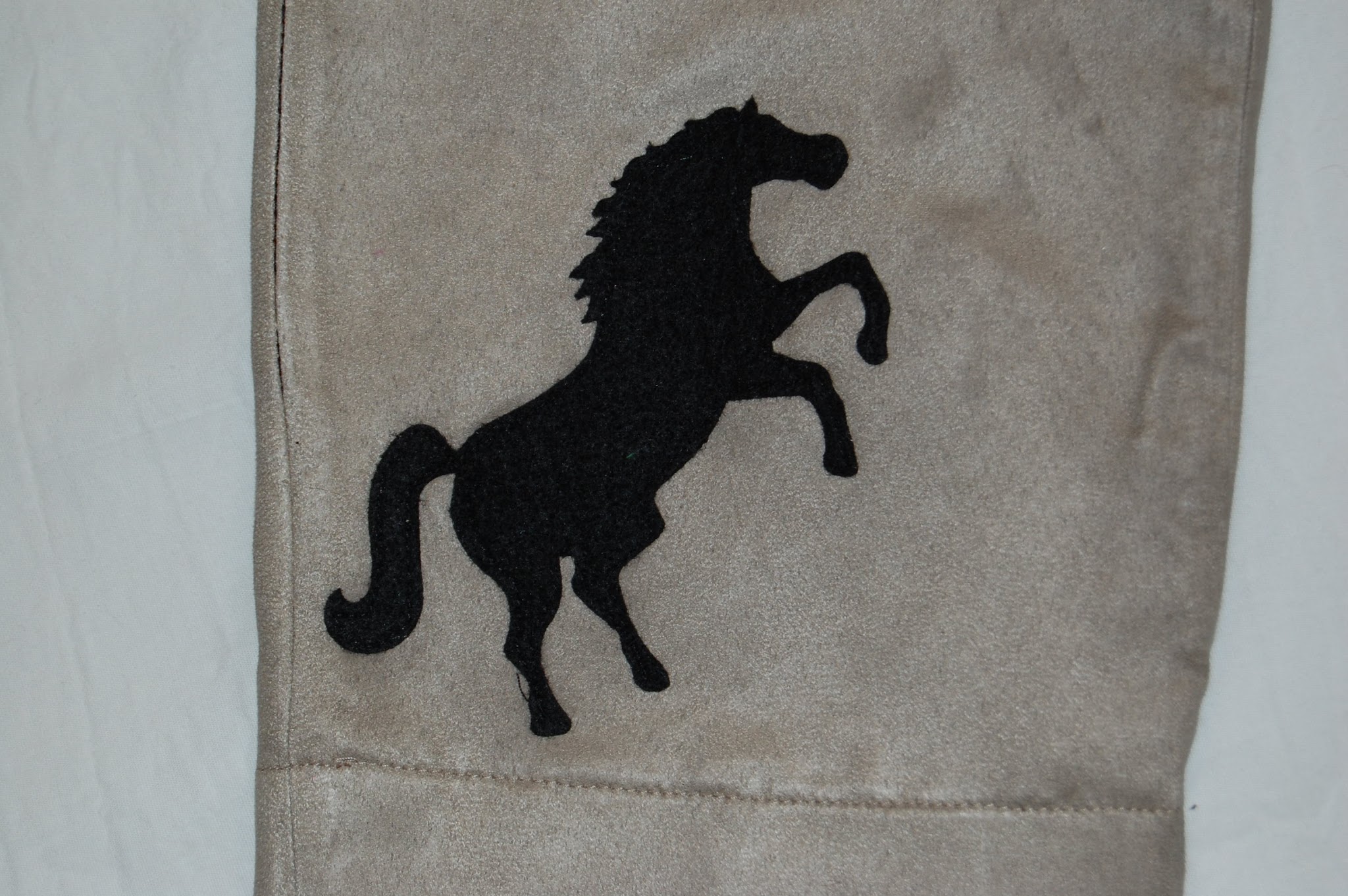

Fun So Far. I bought this so I could cut out fabric for my partners boy clothing line. Her designs are a blast!! Interactive cloths for the Boy!
