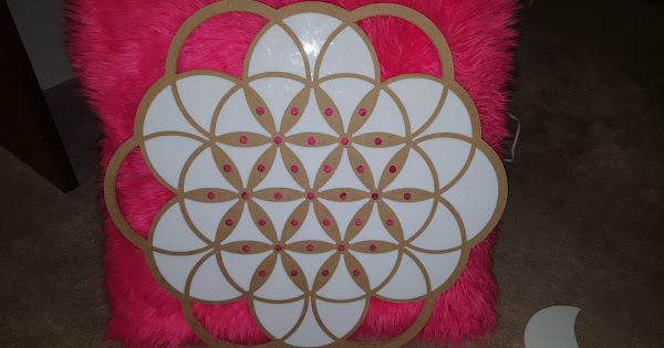

Here is another piece. Basically going to do something similar to this one but with fibonacci…
Google Photos
Sounds cool, Justin, can’t wait to see it!
