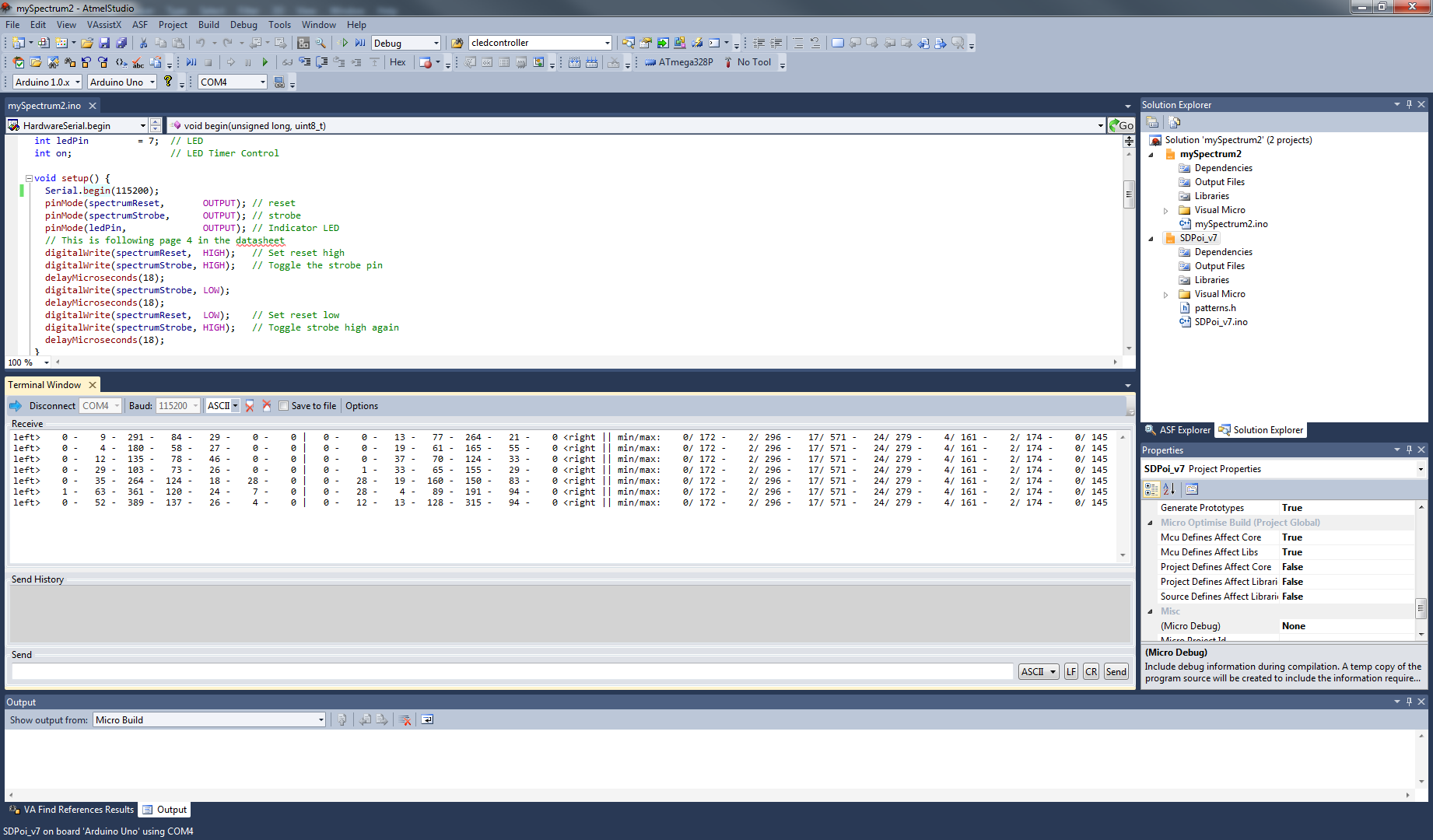

Well, this is fun. Working exclusively inside of AS6 with the addition of Visual Micro: http://www.visualmicro.com/
In one window I have a spectrum analyzer loaded on an Uno spitting out data to the serial terminal. In the other I have my POVpoi code loaded with breakpoints. I can write, compile, and upload straight from this. Neat! I did not have to do any magic to make it work either, just install Visual Micro and it takes care of everything when you first launch AS6. I have it configured to be able to use both Arduino IDEs 1.0.x and 1.5.x, as well as the Teensy Loader.
Right, why did I put this here? Well, because I can open the built-in IO View and monitor pin statuses on a step-by-step basis. That was my main reason initially to doing this: I needed to know what the spectrum sketch was doing when it wasn’t working. That’s when I realized the author didn’t follow the datasheet correctly and I rewrote the thing.
On something like FastLED, while I haven’t quite figured out yet what benefits this gives, and this is true for any code, I am able to use breakpoints in my own code to monitor the various errors and statuses at any given point in the full code. I uploaded a third image showing the IO view window.
Also, subsequent (re)compiles goes a lot faster because it’s only doing those files that changed, unlike the Arduino IDE which recompiles everything every single time. One of my bigger pet peeves with the Arduino IDE.
