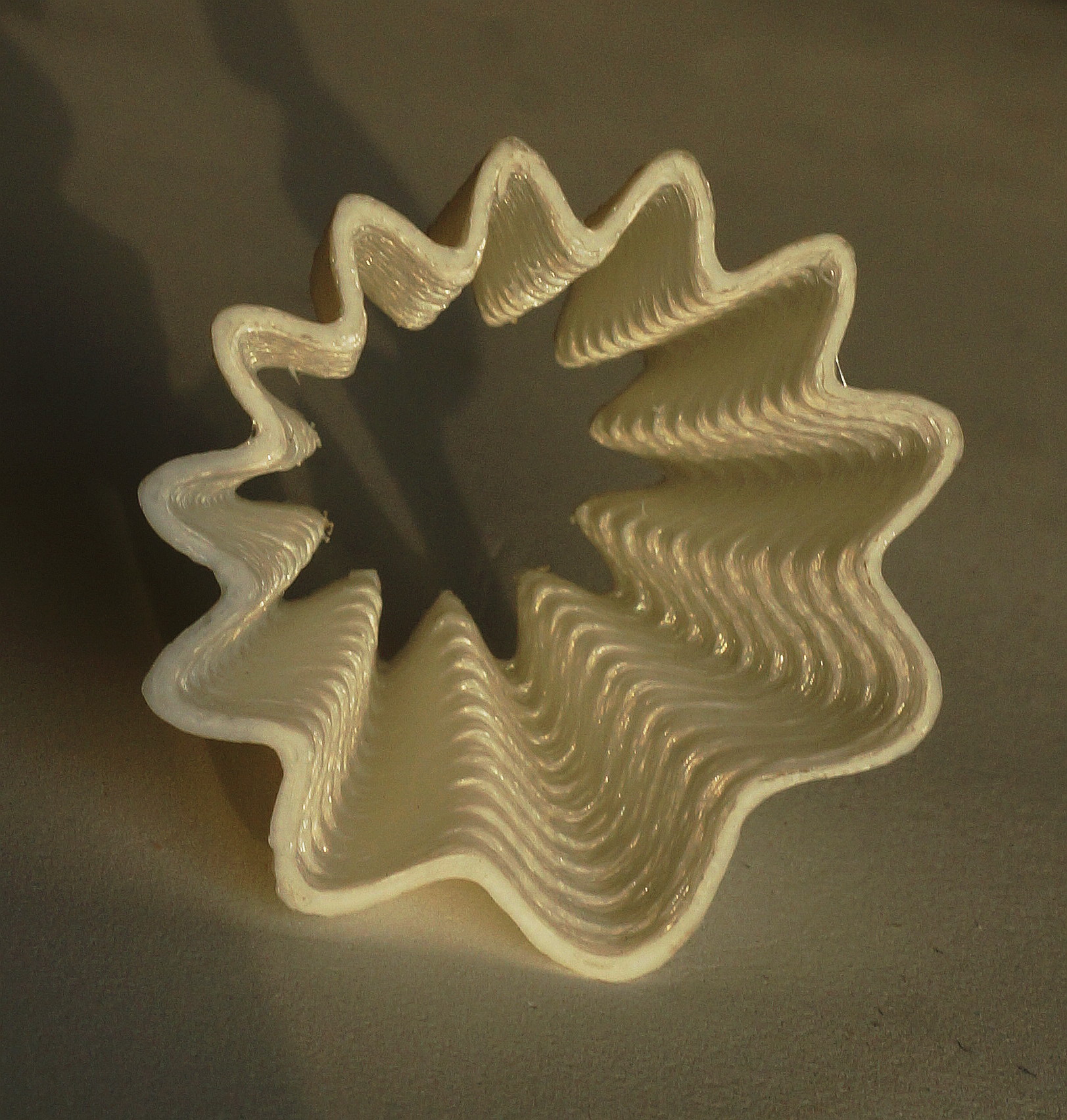

Wellenbecher d026|17 starting with a symetrical waveform which interfere with another wave and widen.
