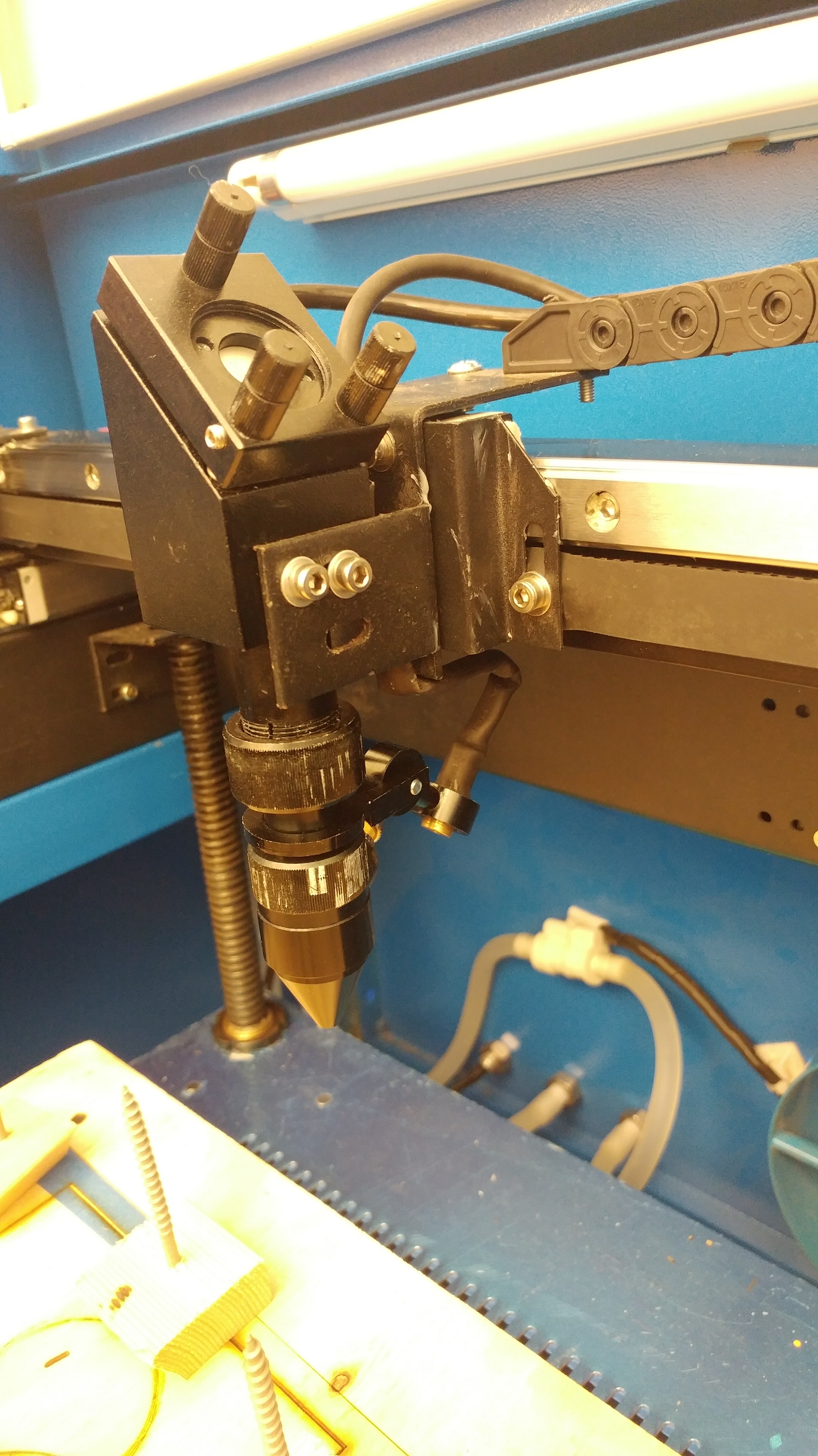

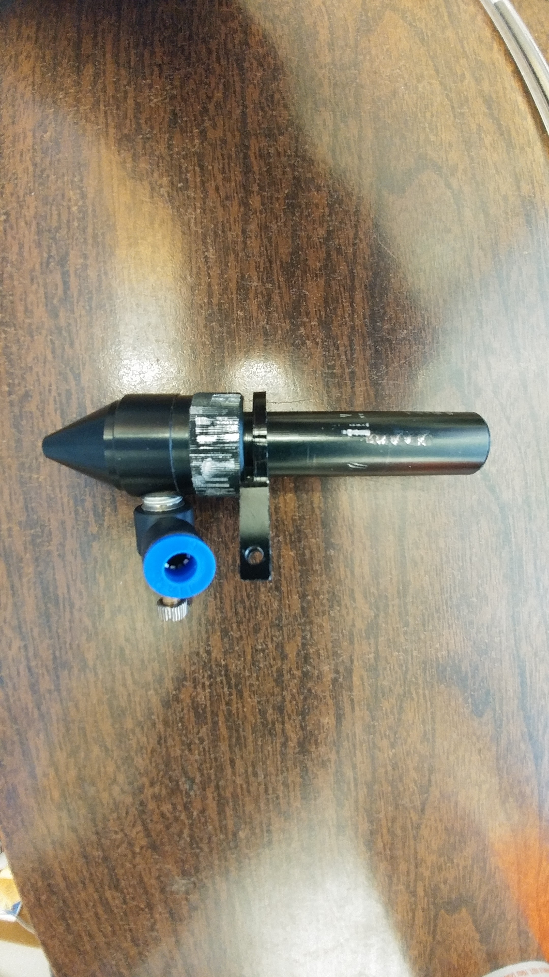

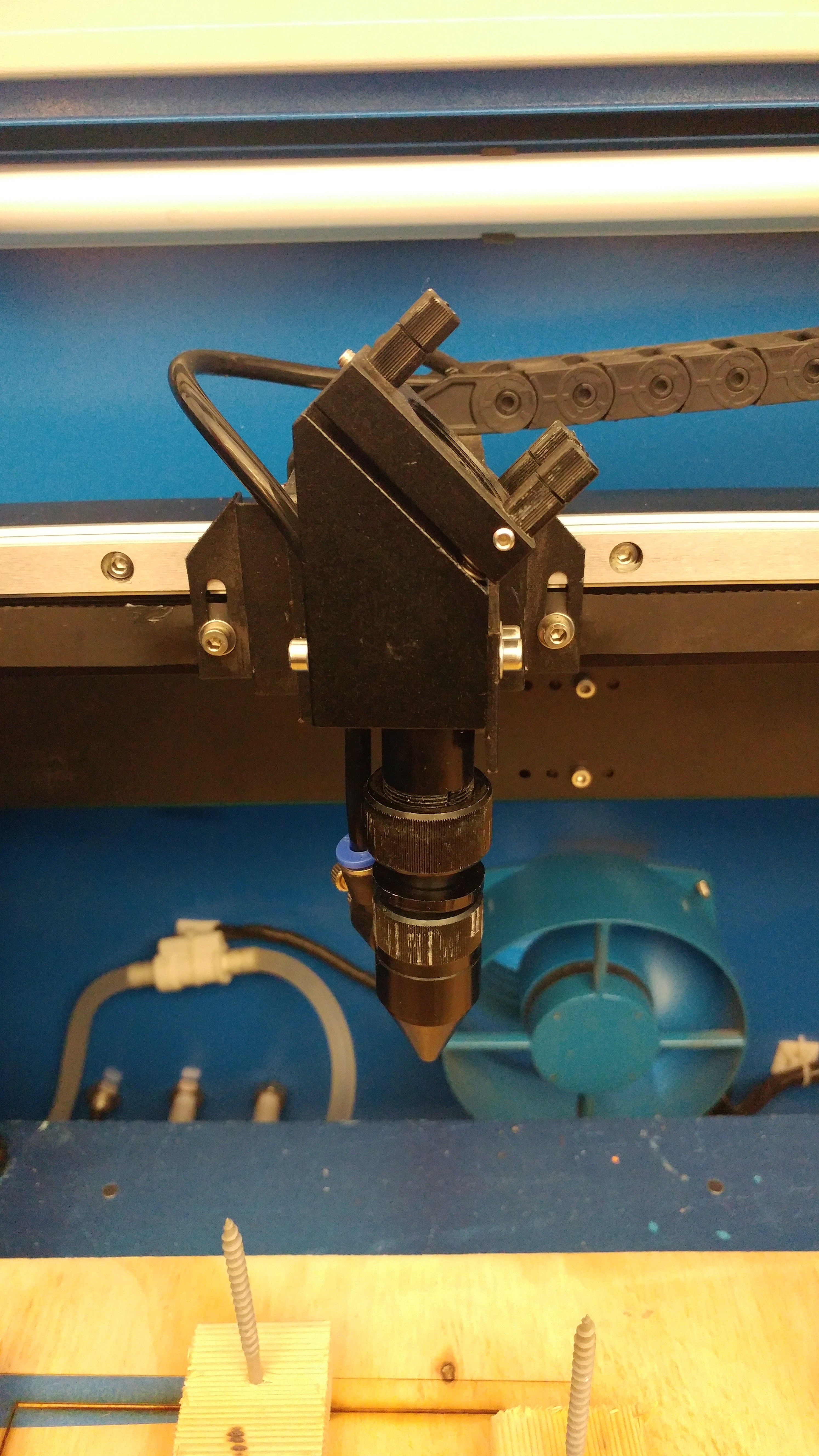

Went to clean the lens today for the first time and couldn’t get the bottom section were the lens is held apart.
Anyone had this issue and managed to solve it?
Marked the head up a bit trying to get it undone

Gentle heat and a soak in penetrating oil ought to do it. (if it’s not yet galled)
Aluminum (like stainless steel) galls. This a a very nasty property, that, once initiated is totally destructive. What happens is the 2 parts actually fuse under relatively low pressure and weld themselves together. For this to happen requires a clean surface (or usually bad luck and lack of lubrication). I don’t claim to understand the molecule mixing that makes it happen, but sure know the feeling when it happens. You can have it happen just threading parts together by hand to test fit them. Once they start to grab, it’s all over but the shouting. ALWAYS Lubricate the big 3 culprits (Aluminum, Stainless and copper - I believe some exotics like inconel are prone as well, probably because of the nickel content) before even touching the parts to each other.
If you soak it and get some oil in there, it will probably prevent galling as you back it out, but I expect it has already occurred.
I’m guessing that the manufacturer galled it by putting it together dry.
If that’s the case, you may as well order as new head(and lens), because that one is destroyed. If you have not yet upgraded to a quality air assist head with adjustable focus, now is a good time.
Lightly lubricate any Aluminum, copper, or stainless steel threads before assembly. (threadlocker like Loctite works as well if you need it’s services but still want to protect your threads)
Silicone based grease is what is used in most industrial assembly, and it’s clean, cheap and resists most chemicals and solvents (which is probably why it’s so popular for this application. If you need just a dab, shop for the little pouches of “dielectric” or “light bulb” grease in your automotive section. If you want a larger supply, Ebay, or NAPA have it in small tube to large tubes.
In a pinch get ANY lube you have on dry Aluminum threads, even a drop of used motor oil off of a dipstick can save you in a pinch.

Looks like a well made head. I would say go with the replacement if it’s not so effected. Check it and lube with silicone grease right away. tighten gently and maybe buy/make a spanner for the collar.
It may be the manufacturer is aware of the problem. If they have been putting them all together dry, you can’t be the only one with a problem.
