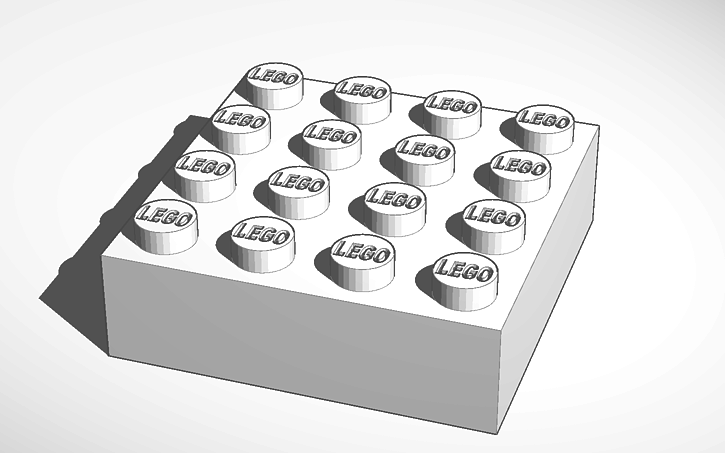

I would like to have it capable of printing things such as
And be able to have the “LEGO” part show up

Interlocking lego pieces are one of the hardest things to print. FYI
.002mm tolerances…
@Camerin_hahn So there is no 3D printer within my price range that can print that accurately?
What printers could get the closest to that accuracy but yet are around $500?
You can’t print that level of detail using an extrusion (FDM) printer, as the narrowest line of filament is about 0.5mm, and the writing is much smaller than that.
You might be able to print it with a resin-based printer (DLP or laser) but those cost way more than $500. And the resulting pieces are soft/fragile.
And even if you ignore the writing, the “snap” of Lego requires extremely precise control over tolerances, to the point where even industrial injection molding isn’t generally good enough - it took companies many years to work out how to copy Lego even badly.

The only thing I can think of that would work is a printer with one of @Jerrill_Johnson nozzles. He goes down to 0.10 mm width. That’s probably the smallest you’ll ever get on a FDM. I wonder if he tried Legos on it. You’ll still need an extremely well calibrated machine, and print really slowly.
@Stephanie_A Thanks for the mention. The inset on the lettering is 0.40 mm wide, so a 0.20 mm or 0.15 mm nozzle may work to get the lettering detail. The trick is going to be the bridging on the underside of the part. It’s really hard with the smaller nozzles. One thought is to print the piece in two parts and glue them together before futzing around with the bridging too much to see if you can get the interlocking parts just right.

@Stephanie_A interesting idea using 0.1mm nozzles. You are right that would probably be able to do the writing. Very slowly. With dual extruders, some folks are using a ‘fat’ nozzle for speed printing the interior, and a ‘narrow’ nozzle for exterior for the sharp resolution. That might be a good way to go, though not for $500.
You should be able to print them upside down with supports.
@Stephanie_A to get them to interlock you have to have a smooth top.

I guess that part won’t be available for long anyway. Some companies don’t like their trademark being abused.
@bob_cousins you mean that Lego block? I had created the text part just to see how close to the real deal it could get… And then to see if it could print
Printing with a small nozzle is just like the larger one, from a software perspective - you just configure in the smaller nozzle size into the software, and it generates more lines of plastic to lay down, closer together with less plastic. The smaller the nozzle, the more precisely calibrated your printer needs to be, though, and the longer the print will take. The plastic volume extruded is based on the cross section of the nozzle, so going from 0.4mm to 0.1mm gives you ¼ squared = 1/16th as much plastic extrusion, so your prints will take 16x as long. Ouch! But that might be fine for printing one amazing part for display or casting.
