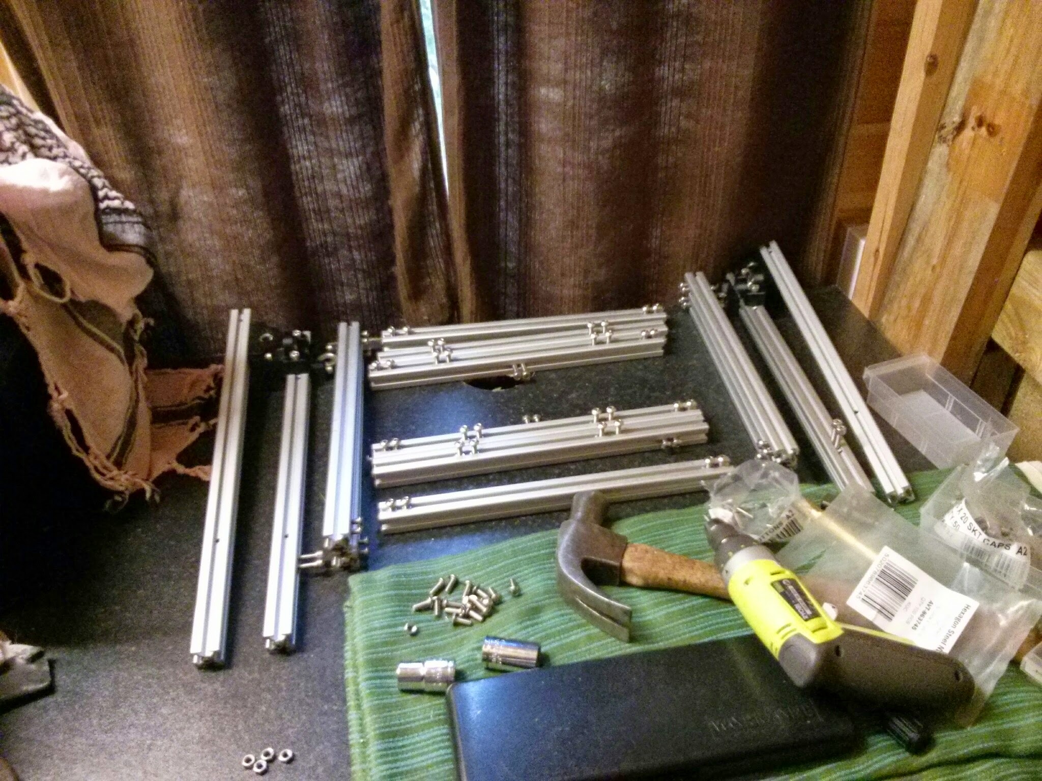

What a difference a tap makes. I was having awful problems tapping the centre of the extrusions, the tap was getting gummed up with aluminium so I decided to treat myself to a new tap.
Once I started using the new tap everything was fine. I used a piece of wood with a 5mm hole drilled through it with a pillar drill to start it off nice and parallel. After that I backed the tap out and continued by hand. Using a ratchet tap handle was ideal.
I then made a load more of my cheap tnuts (grind two edges down a bit off normal M5 nuts) and loaded them into the extrusions and put the thing together.
It’s terribly out of true and after looking the Eustathios design does have many braces so that’s my next job.
