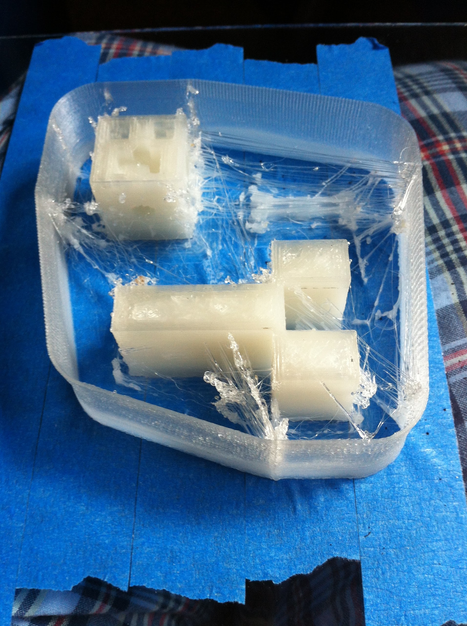

What a mess and what is with the soot?
What a mess and what is with the soot? Extending the skirt and sprinting multiple objects at once exposed several other problems. I don’t have cracking in the corners anymore which is likely either the skirt or greater time between layers.
There seems to be a lot of back pressure in the nozzle. If I increase retraction I get blobs. After experimentation, I’m not certain that there is a sweet spot. Maybe the temp is too low? Increasing the temp leads to sagging top layers.
Also, what is with that discolored plastic and the black soot? I thought the kapton might be charring but I can’t find evidence of that.

Looks like you’re simply oozing between travel moves. You’ll want to play with retraction settings, possibly a cooler temp, and keeping your hot end cooled off at the upper portions. Other things that can help are “Z-Lift” and fast travel moves.

That is in no way natural ABS. Natural ABS is not translucent like that. Where did you purchase it? This is what natural ABS looks like when printed: http://www.lulzbot.com/sites/default/files/styles/uc_product_full/public/p/newimages/2012/11/DSC_0318.JPG
Being that yours is slightly clear, it’s probably some off the wall formulation. My suggestions from above should likely still apply though. 205 is a little low for “ABS” though. 230C is the typical temp.

I’ve never seen transparent abs. I’m guessing that @ThantiK nailed it and this is PLA.
If your nozzle is loaded, when you heat it up, what temp does it start oozing out? Go for about 15-20C hotter than that. Try 193 and see what happens. Also, are you using a fan while printing? Does this “abs” stink and give you a headache while printing? Or does it smell like waffles? Mmmm, waffles.

@Daniel_Bull , @Matt_Bordoni , I dropped the temperature down to 195 and the cube walls look a lot better. I think the stringiness is better as well (despite the skirt detaching and being dragged repeatedly over the surface for the first 50 layers…) This may resolve several of my problems at once, including some bed adhesion issues. Thanks.
