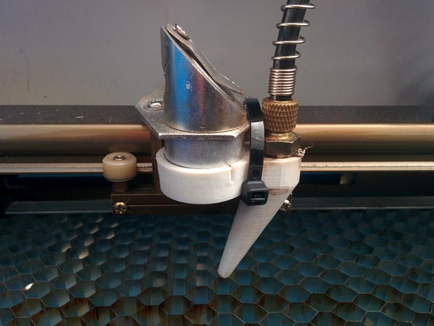

This air assist in my opinion is better then the light object it creates we s a jet of air right at the laser point. Compare that to the LO air assist head which just created a gentle breeze all around
@raykholo This is the end result of my design I have been working on. It was 3D printed on a resin based printer by someone local at 3DHubs. If you are using 3DHubs at all, there are some refer codes on my page that will give you US$10 off the print (>$25 prints) https://plus.google.com/+YuusufSallahuddinYSCreations/posts/iTbTG7u75DC
It is designed to focus a cone of air at the focal point of 50.8mm, with the intention that the cone of air creates a barrier that prevents any smoke getting to the lens region (requiring less cleaning). From my observations whilst using it, it seems to do just this, even with the horribly low pressure I am using for the air.
I plan to upgrade my air pressure/flow as $ permits & as I find a suitable compressor/airpump.
Here’s the STL file if you are interested in taking a look/printing one: https://drive.google.com/file/d/0Bzi2h1k_udXwRHpZTWc1SHpSenc/view?usp=sharing
