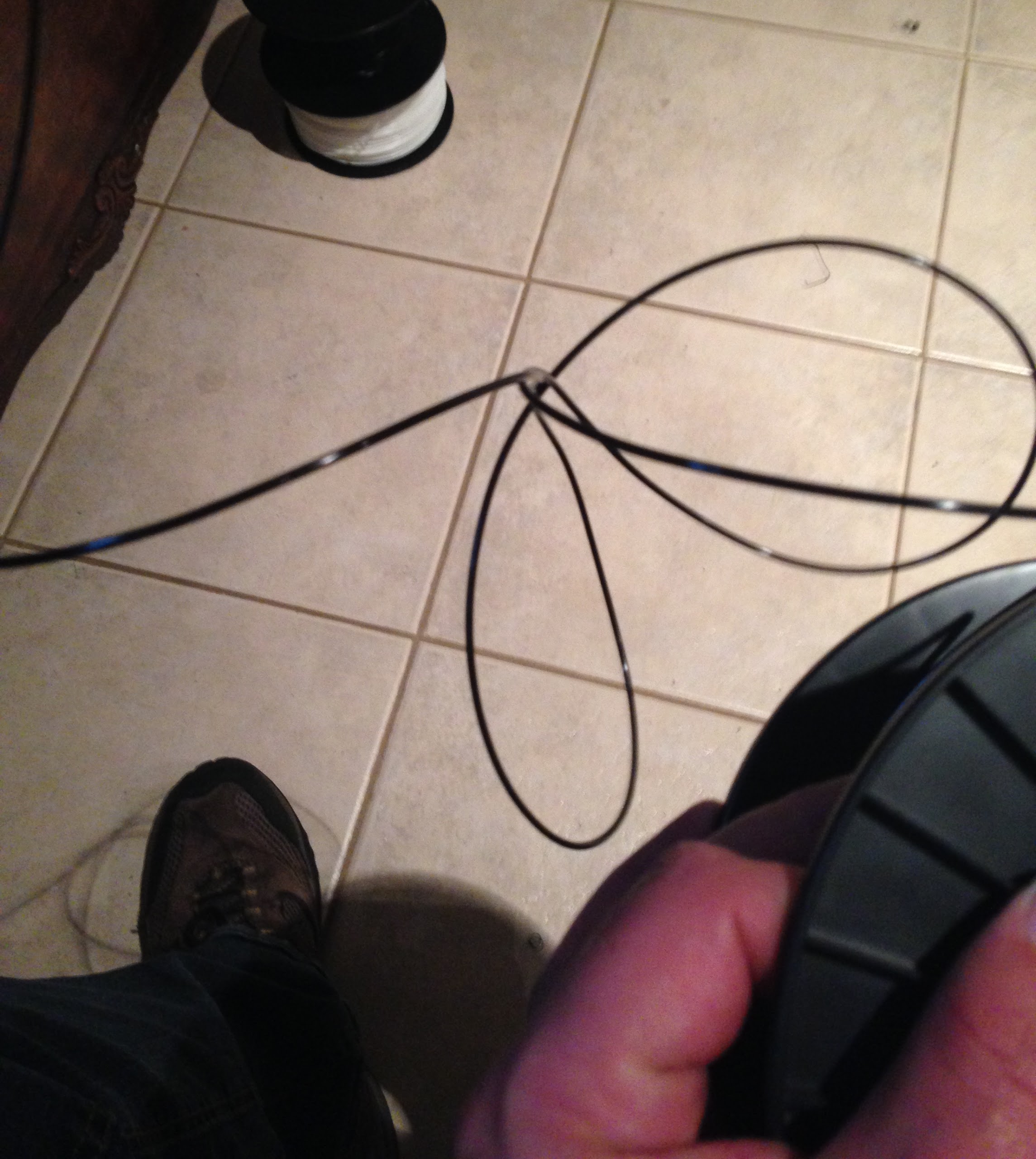

What am I doing wrong to get the filament to twist like that during a print ?
It may be the way it was wound on the spool. How are you letting it unspool? Vertical? Horizontal? You should also have at least a little bit of tension on the spool so that it doesn’t unwind too much while feeding.
You remember your first question? Horizontal versus Vertical feed. Well if you pull filament off the side of the roll it holds the twist that it got while being rolled. Pulling the filament off ‘vertically’ or essentially unrolling it while printing undoes the twist as it unspools.
I am vertical but left to the extruder. Mounted on a pvc pipe that is smaller than the spool hole diameter.
I will make a jig tonight so that the spool is top center behind the extruder.

@Andre_Courchesne1 I think the problem is the same as I have seen with other cables on spools (including fishing line), when the product is wound on to the spool it is done so under tension, this is to get the cable (filament) to pack neatly so it should then come off easily, the problem is the inner layers are still under tension and act a little like a spring, when the tension is released it tries to unwind off of the spool, and that is when the tangling occurs, to prevent it from happening you need to maintain some tension between the spool and the extruder to prevent the filament from unwinding and tangling. Something to lightly brake the rotation of the spool should work.
