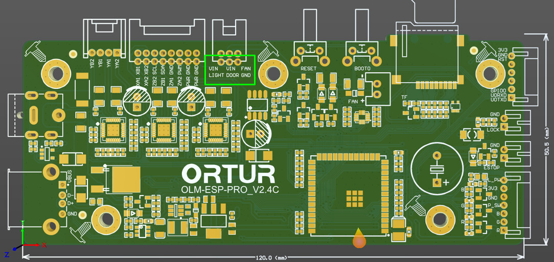

I spend a lot of time around industrial equipment with interlocks due to moving parts, but I’m not sure how to build one into the LM3, I don’t think that it has an interface for one. Would building an interlock into the PSU be a problem, for example, simply cutting the mains supply?

I got ahold of Ortur support to find out the laser module interface details.
They want to know what machine: Ortur LM3?
They also want to know what laser module is installed?
Absolutely vanilla lm3 10w, still in its shrink wrapping as I’m waiting on the camera for the enclosure to arrive.

Update from Ortur support:
The tilt is prebuilt in the machine, if you tilt it or shake it it will stop
However, there is a DOOR pin on the back of the motherboard, I am not certain however if the firmware already implements this
If you notice Theresa 6 pin,
I think this [Theresa] was meant to say “there is”.
Note that there is a “DOOR” label on the 6-pin connector.
The support contact is checking with development to see if that pin is implemented in the firmware. I am guessing that if this pin is grounded the controller will pause. If so you would connect this pin to the interlocks wired in series.
I’m worried that this would void the warranty if I used it.
It’s unlikely they would void the warranty for using functions they built into the product.
You could ask Ortur support directly.
The bottom line is the functions you asked for seem to already exist in the product.
