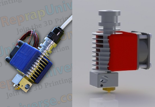

Ive been looking at getting the Bulldog xl extruder and using it with the dowden E3D. I know the bulldog has a gear ratio of 5 to one I believe so might not move very fast.

Does anyone prefer having the bowden design compared to the tradition connecting it directly to the extruder
The two benefits are making the head lighter and keeping the drive motor for the extruder out of the heated build environment. The first means you can reduce the other mechanism bits to lighter and cheaper ones for the same speed, the second means that the stepper or other drive motor wouldn’t usually require active cooling to continue functioning.
Thank you John ridley for the feed back. I think that changed my mind on the bowden design plus it will be a little cheaper. Only pros I’ve figured out is faster prints getting the extruder out of the area and no wiggle effect. Cons can’t print flexable stuff hard to calibrate, hard to load, has problems with retraction and oozeing. Which is all stuff that I don’t want with my knew machine thanks everyone for the help
