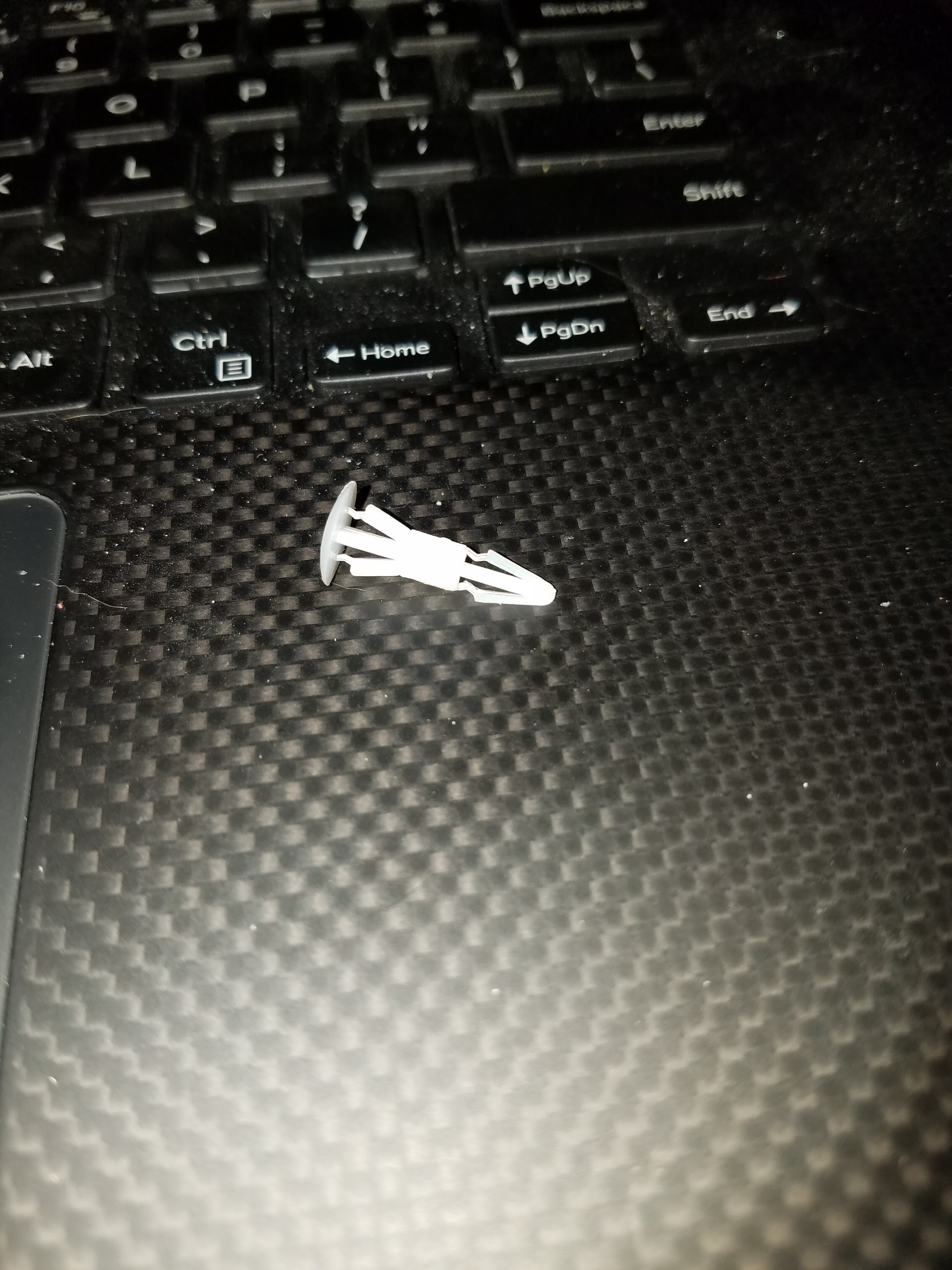

What are these fasteners called, exactly, and where can I buy them?
What are these fasteners called, exactly, and where can I buy them? (Robo uses them to mount Raspberry Pi boards in their printers.)
Looks like a panel pin.? Not sure what the exact name is
Bottom entry nylon board supports.
https://www.nyfast.com/reverse-circuit-board-locking-support/10249-reverse-circuit-board-locking-support-4.html
Go look up PCB Standoff
That’s a broad category which covers all types including these.
Use digikey
Surely those could be designed and printed :wink: gotta try that

Oh, weird my most recent comment didn’t post last night – the correct term was actually reverse mounting board supports-- where they enter in the same direction on both boards, versus the conventional supports where the mating surfaces are facing each other. You can find them here: https://www.digikey.com/products/en/hardware-fasteners-accessories/board-supports/578?k=nylon+board+supports&k&pkeyword=nylon+board+supports&pv5=11816&pv5=11815&pv5=12219&pv5=11817&mnonly=0&ColumnSort=0&page=1&quantity=0&ptm=0&fid=0&pageSize=25 – I’ve been staring at supports, standoffs, and spacers for a project lately, so you asked at the right time!
