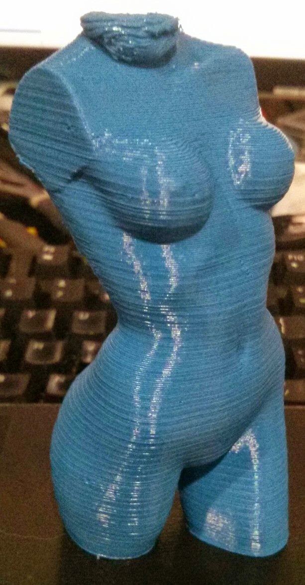

What causes the problem you see at the top where it seems like there's
What causes the problem you see at the top where it seems like there’s too much plastic being extruded, and the extruder ends up making circles and a “divot” on top of small areas? Printrbot Jr. I’ve run into this on other prints. Otherwise it printed great; in person it’s not as “layered” or ridged as it looks in this camera phone picture.
It might be that you’re too hot and the extruded filament isn’t cooling/setting enough before the nozzle passes over it on the next layer and disturb it. You might need to adjust your minimum layer time. Or, if it’s just this print, turn on an external fan as you’re nearing the top.
That’s quite a bit of banding… Is your filament diameter consistent?
Yes; it looks better in person (versus this close-up light-shiny shot). I think you’re right about it not cooling enough before it gets mushed around by the nozzle… Time to tweak. Using repetier-host (latest version). I’ve got the fan installed on my PBJr, and it was running for this bit…
By the way, the ridges is probably due to z layer height aliasing — if your z screw is SAE and you’re using a metric layer height like .2 or .3 mm then your layer height will not be a full number of Z steps and you will get this rounding error.
Re the over extruding: I’ve found I need to turn the extrusion parameters way down in order to not simply be extruding too much plastic. I have a .77 in there at the moment.
Thanks, yeah it’s the SAE screw that came with the kit, and I’m using .2. Need to look up the .2fraction someone posted that works better with the SAE screw.

Regardless though, that shouldn’t matter — there’s a couple of variables that affect flow rate ultimately: the extruder calibration (commanding extrude of 100 mm should actually take in exactly 100 mm of filament, which is a measurable quantity you can calibrate), the diameter of the filament you say it is (which affects slicer’s length-to-volume factor), the extrusion multiplier (which does indeed come out really low on mine and several other people’s Simples), and the print panel’s flow rate multiplier slider.
There’s a couple of suggestions for calibrating flow rate, the one I followed was to slice a calibration cube with .95 infill, and calibrate to the point where infill layers would just have gaps between strands and top layers would not have gaps. Getting this right is hard and takes some effort & time, particularly when overfilling for a while as well as underfilling for a while affects the z height of the already laid down layers, and thus very directly affects your measurements.
What I would do is change the rate via the print panel slider (under- and overfilling in various parts if the Z looked to be significantly off, with the goal of a flat starting surface fire next few layers), then when I had a setting that appeared to print proper for a dozen layers multiply that into the extrusion multiplier and iterate. I’d say the .77 I have is within about 5% of correct.
