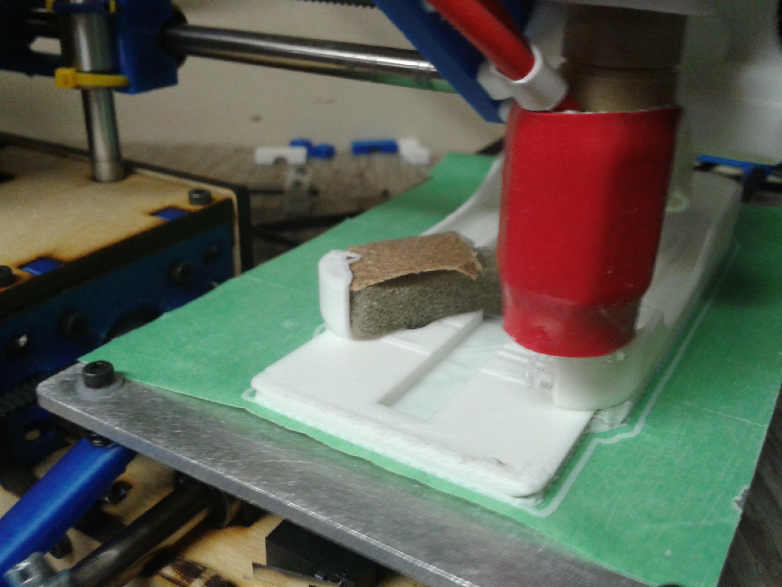

Some quick thinking, double sided tape, packing foam and piece of sandpaper and I was able to save this corner over hang from disaster - all without pausing the print job might I add.
KISSLICER’s supports algorithm really annoys me some days. I happened to catch this corner of a custom phone case about to be screwed up because the supports never stuck - it would extrude them, but because it started wrong, they got carried over to the other corner and wiped off. As a result, there was no support being built in this corner. The foam supported sandpaper gave the overhang something to stick to and saved the print!
BTW, this was the print I mentioned earlier where the skirt and supports were trying to go negative X on me. Otherwise it turned out fine.

Ooh, cute. My print-saving has mostly been limited to sitting there pushing a pencil or a coffee-stirrer stick down on an errant corner that was lifting up, until the build got thick enough not to curl. (A lot less of this since I learned it was a good idea to round distant corners.)
