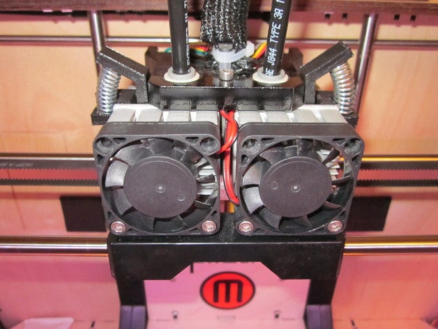

What do you all think about the MK8 extruder? They are derived from Makerbot and feed filament directly into the hot end (using a convenient spring release lever). So if one requires the extruder to not be located on the hot end then this is obviously of no use. They drive directly from the step motor (without any gear reduction) using a standard hobbed gear that sells on Ebay for <$2. Here are two variations:
I wonder if pushing filament directly from the gear shaft without reduction provides enough force, but apparently it must because so many people use them. Another plus is that it is an extremely simple design.
