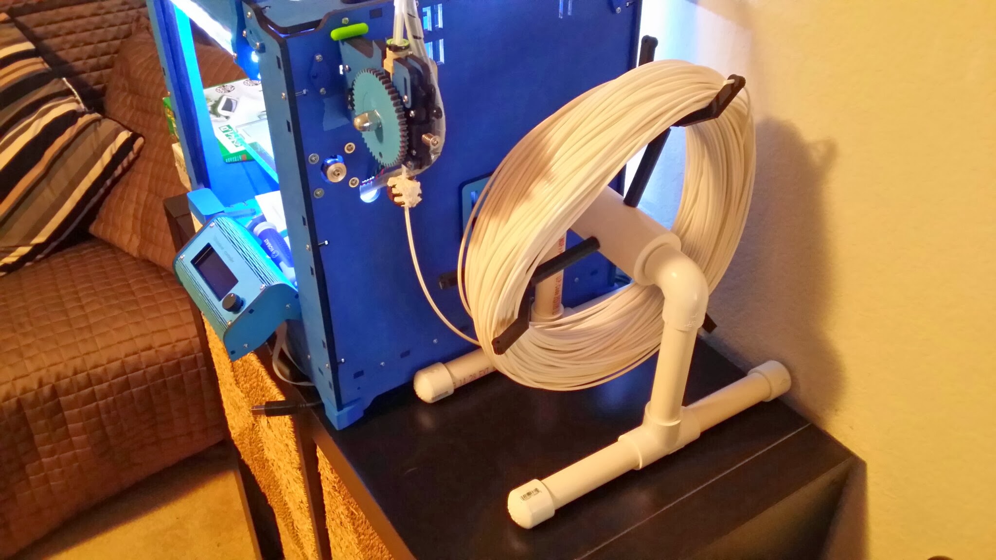

Uploaded to Thingiverse: Spool Core for 3/4 PVC Pipe Holder by RyGuy - Thingiverse
Originally shared by Ryan Matthews
Threw together a PVC pipe air spool holder. Got a deal on non-cored filament but it was being a pain to feed so I modded someone else’s design to correctly fit a 3/4" PVC holder. Cost me <5$ for all the PVC parts and I 3D printed the new spindle core. Works well but I still hate non-spooled filament deliveries…

A friend uses this and so far it’s been amazing: http://www.thingiverse.com/thing:252808
