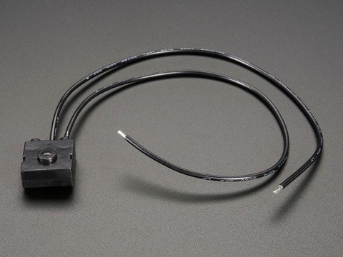

For 3A there is this one: https://www.adafruit.com/products/1400
If you build it for 4A the MosFet won’t get hot
