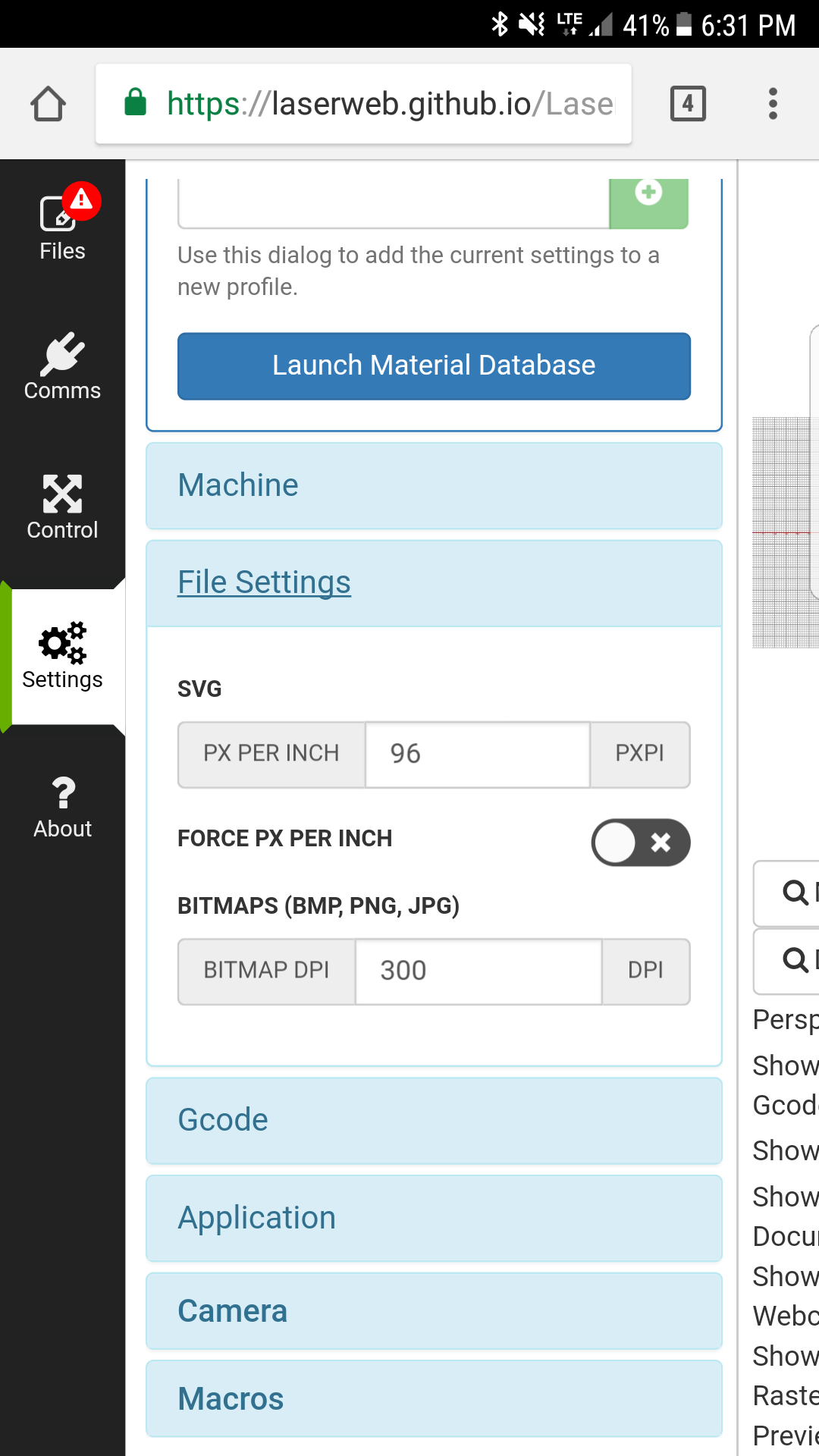

@Ariel_Yahni_UniKpty where is the setting for 72dpi in LW4
Where it says PX per inch
I recommend you spend a few minutes looking at every tab, every settings, and learning about the software. It’s under Settings -> File Settings
I have started to work on the documentation again for LaserWeb. The official docs will now be on the LaserWeb4 wiki. Should be a little better documented in about 2-3 weeks.
That’s done the trick change that to 72 in lw4
@William_Kearns ​ glad it’s solved
