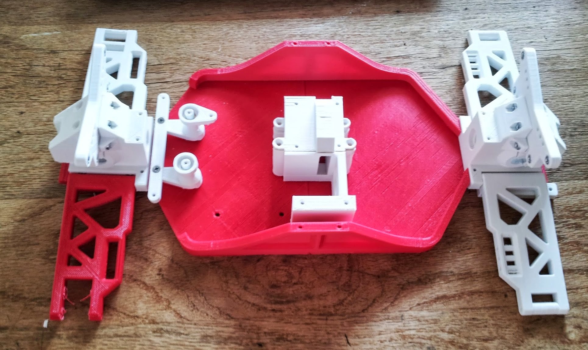

What has everyone used for the wishbone pins? I see welding rod,
What has everyone used for the wishbone pins? I see welding rod, which I have some of, is a viable solution, but I was wondering if anyone found a source for rods that were already the right size or close enough.
Aside: Update on my progress. Printing the wishbones vertically helped prevent clogging issues and the front, rear, and central diffs have printed very nicely as well.
McMaster Carr stocks 3mm shaft that’s a couple bucks for a foot.
i used the rods from the laser carriage in old DVD players (my dads a retired technician and he hordes all the usefull bits :slight_smile:
Looks good. Glad you got the wishbones completed.
