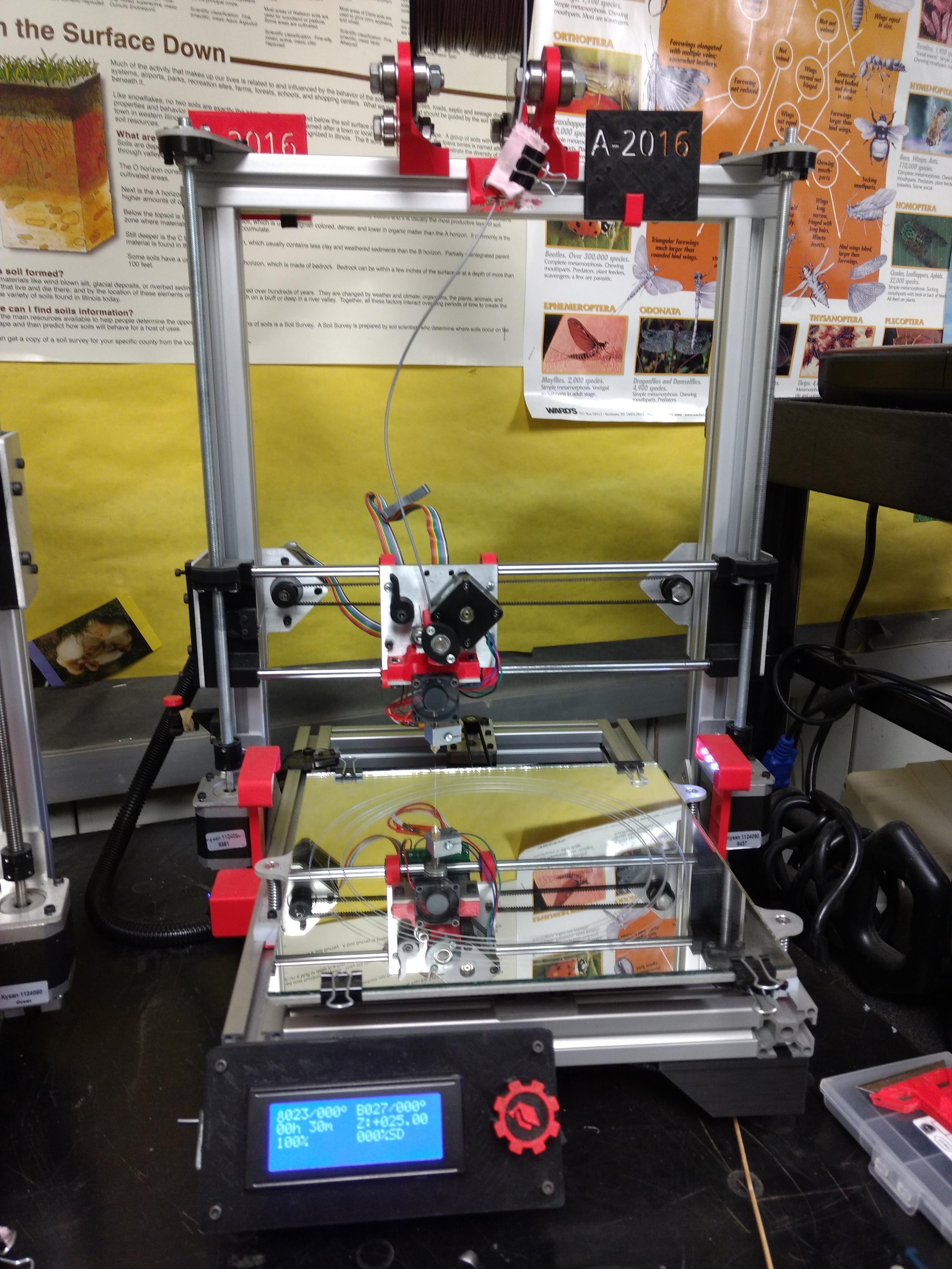

very nice printer ! what type of motors, microcontroller and things to use to do a 3d printer like that ? I like a lot
PTFE spray
@gabcibertech They are from https://osc3d.com/ The designer calls it a FlexMendel. We got them as part of a 3 day, guided, “build it yourself” workshop/grant, for our high school. Motors are Nema 17 and I think the board is a RAMPS.
The OSC is in Bloomington, IL, USA. I highly recommend it. THey also have a Maker Space and other classes.
