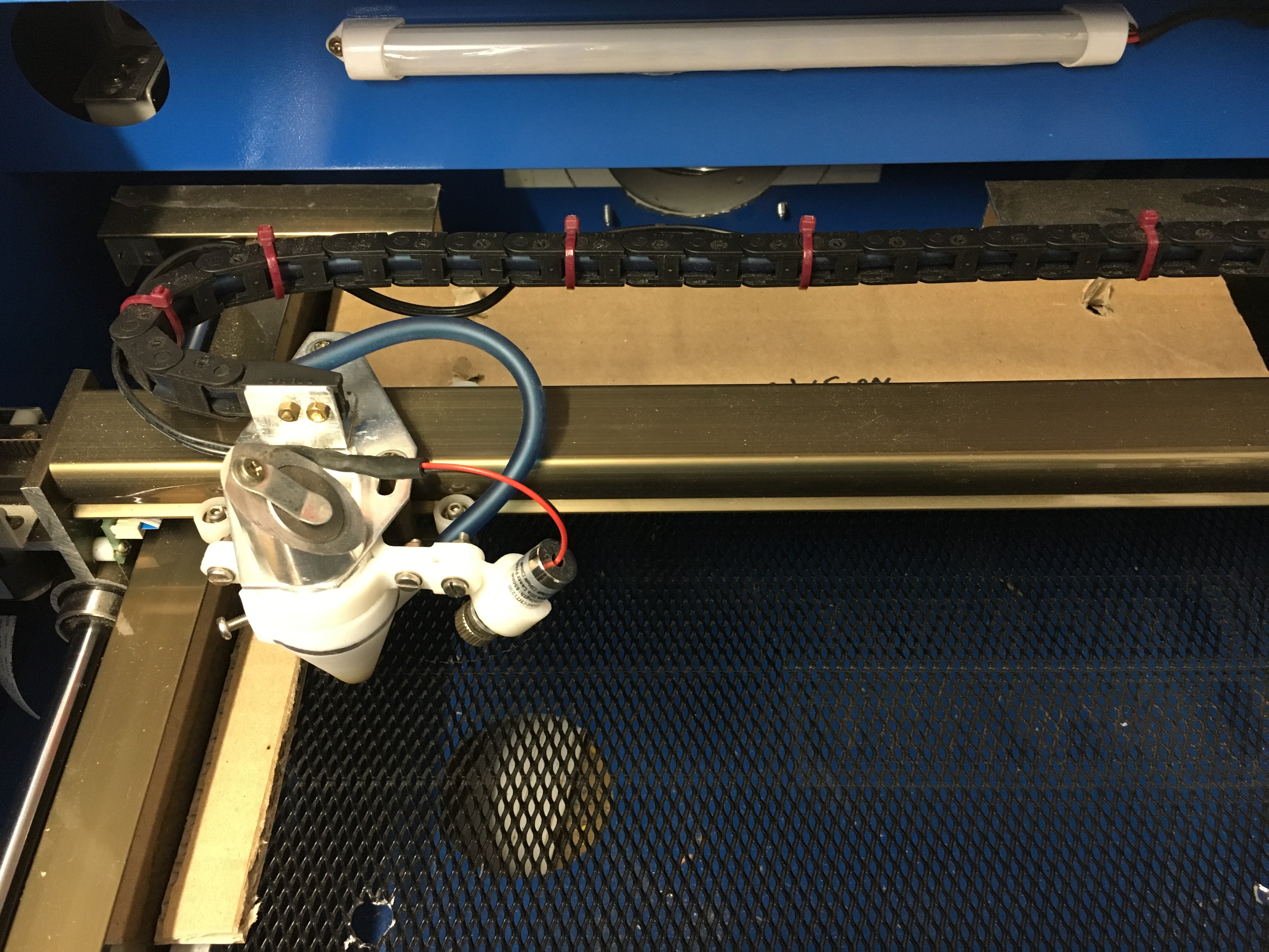

I am using a cable chain but the pipe is kinking where it comes out and loops around to join the laser head, very frustrating.
Try to leave some more slack there, or if possible turn the head so the fitting is coming off at a different angle.

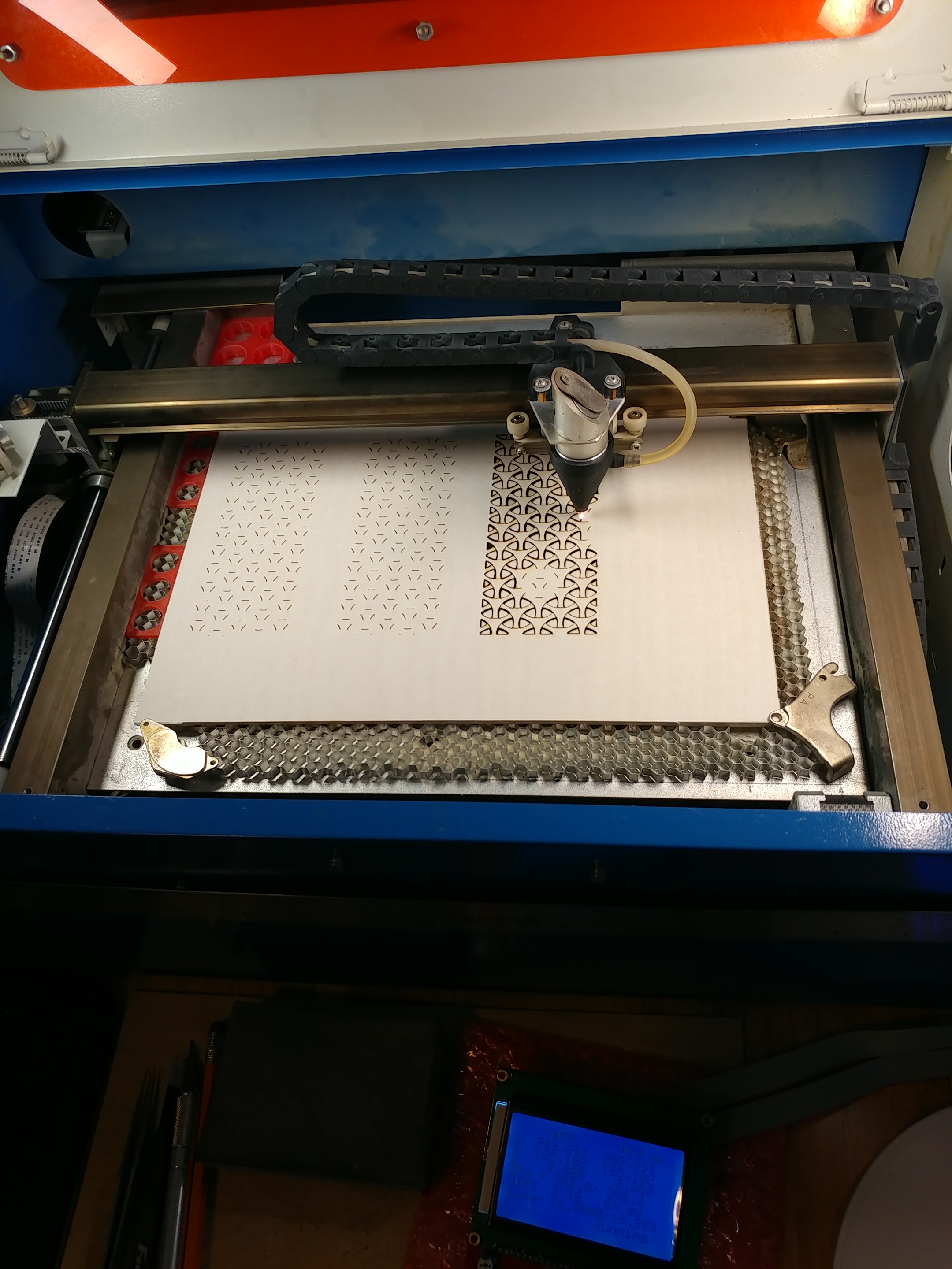

@Ashley_M_Kirchner_No I love how your lcd is still on the bubble wrap and production in the bed
nice bed btw!
@Phillip_Meyer This is mine, chain going towards the back rather than the top. Just wanted to be different than everyone else.

+Joe Alexander, lol, yeah it’s been sitting there because I keep procrastinating on redoing the panel on the machine.
@E_Caswell , actually, almost everyone does it like yours. I’m one of the few that has it on top. I didn’t like how it flops around when I had it the way you do.
