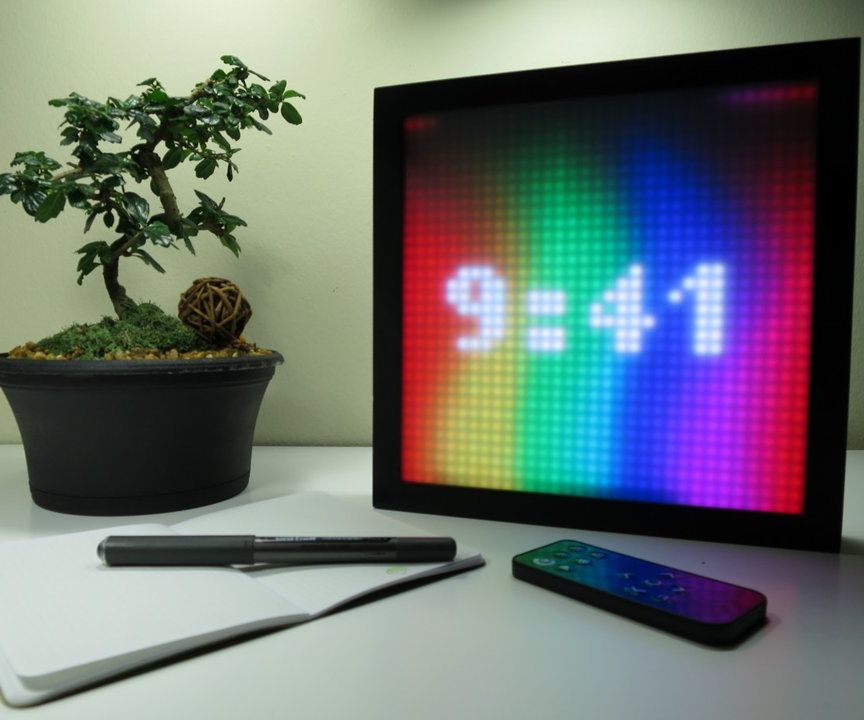

I’m working on a new matrix project and have been trying out these two types of acrylic:
http://www.ebay.co.uk/itm/160472892812
http://www.ebay.co.uk/itm/400248891316
The Opal version can be placed quite close to the LEDs without spotting but does reduce the light output a bit more then the plain frosted. I did try sanding plain acrylic but found it difficult to get a consistent result.
For frosted 43mm and opal 15mm.
