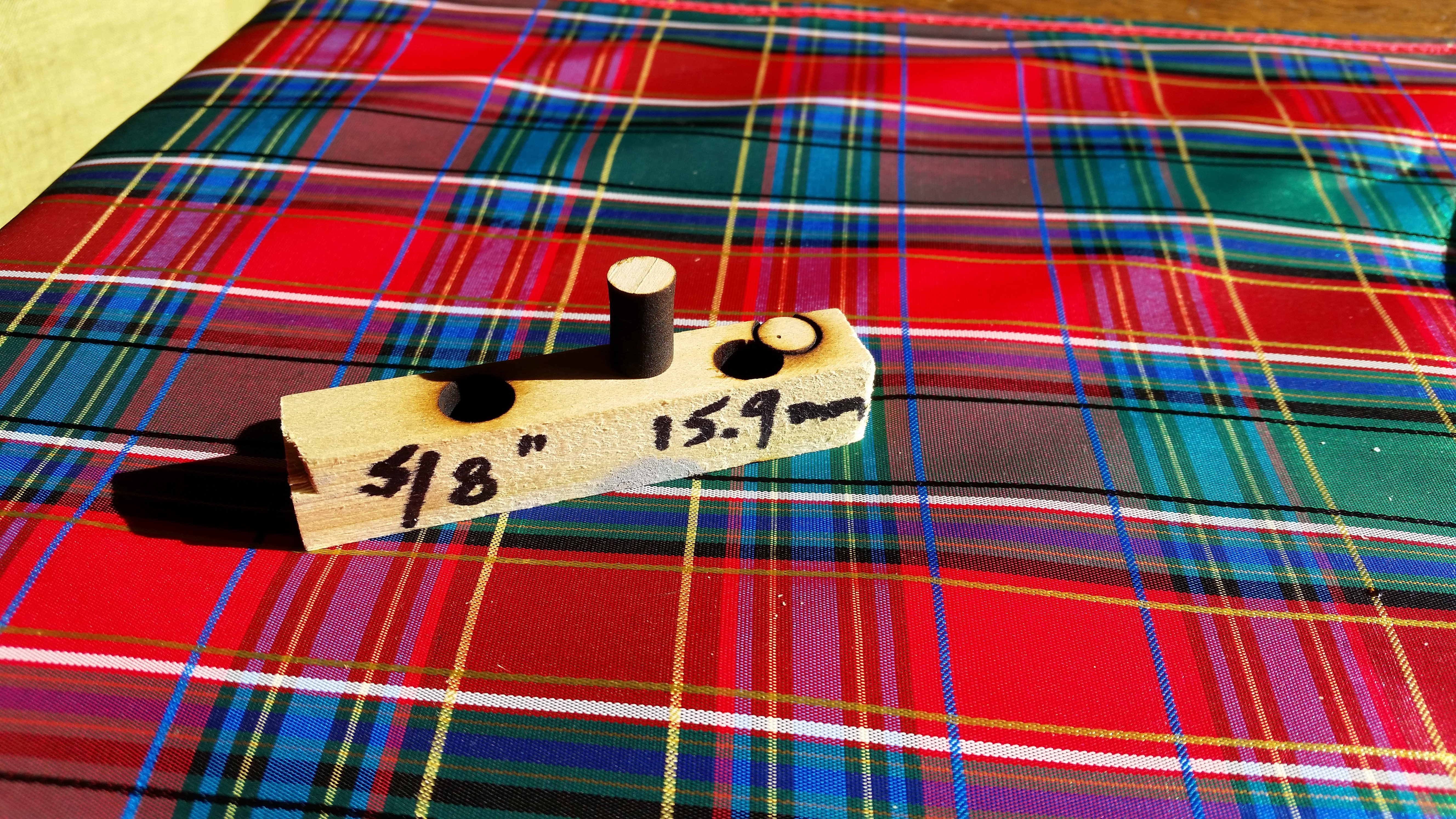

OK…I had some time so I did a test cut in 5/8 (15.9mm) inch Popular. At 11ma, 300mm/min, and three passes with focal point at about center of material. The coolant temp was at 10C. It had no problem going through the Popular. Actually I believe I was high on the power as 8ma would have also worked.
I didn’t use the z axis table because there is a slight wobble in them. Someday I plan on rebuilding the LO table I have making it larger and using roller guides to rid the wobble. Then I can raise it up or down without the side to side shift.
So…I do believe it is within the abilities of the 40K to cut ¾” in Popular but In harder woods maybe 5/8” with multiple passes. However, as others have said using the power (milliamps) on the high end can effect tube life. Also, cooling the tube to just above dew point becomes critical.
