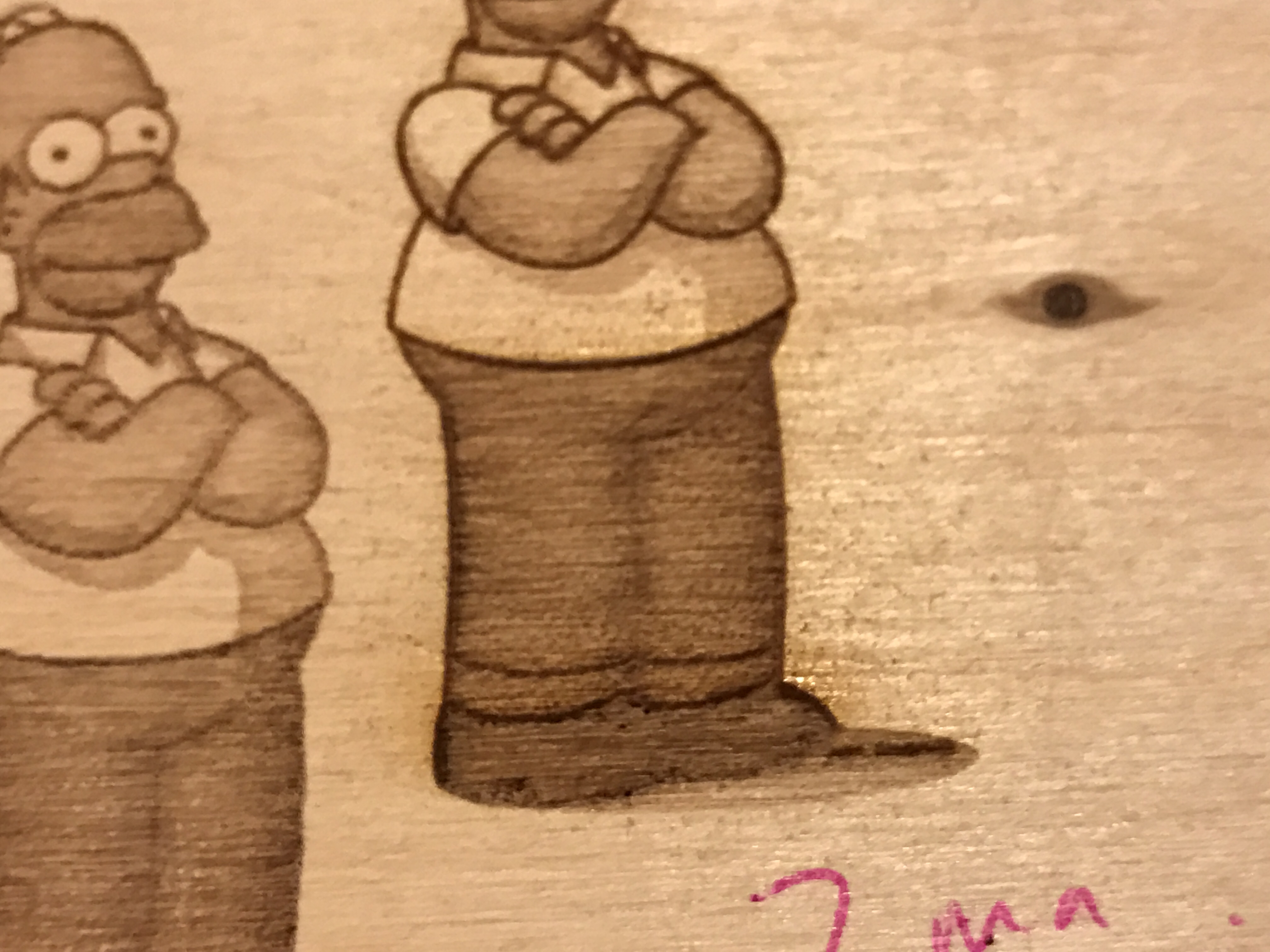

@Ariel_Yahni_UniKpty (null) Are you happy with your end results? I’m getting some pitting in the darker areas, and I’m not sure if that’s down to the material or my settings or both.

@K1111 ​ I see there a very good looking raster. Did you accent the board as vectors? Not sure what do you mean by pitting.
@Ariel_Yahni_UniKpty (null) If you look at the bottom left of homer’s shoe you can see a darker spot. They’re little pits/holes in the material. The borders are not vector. I just took it into photoshop and made things darker.

I will say that is a combination of the darker corner plus more heat for the same reason and material imperfection. I would be very sure that should not happen on let’s say MDF
