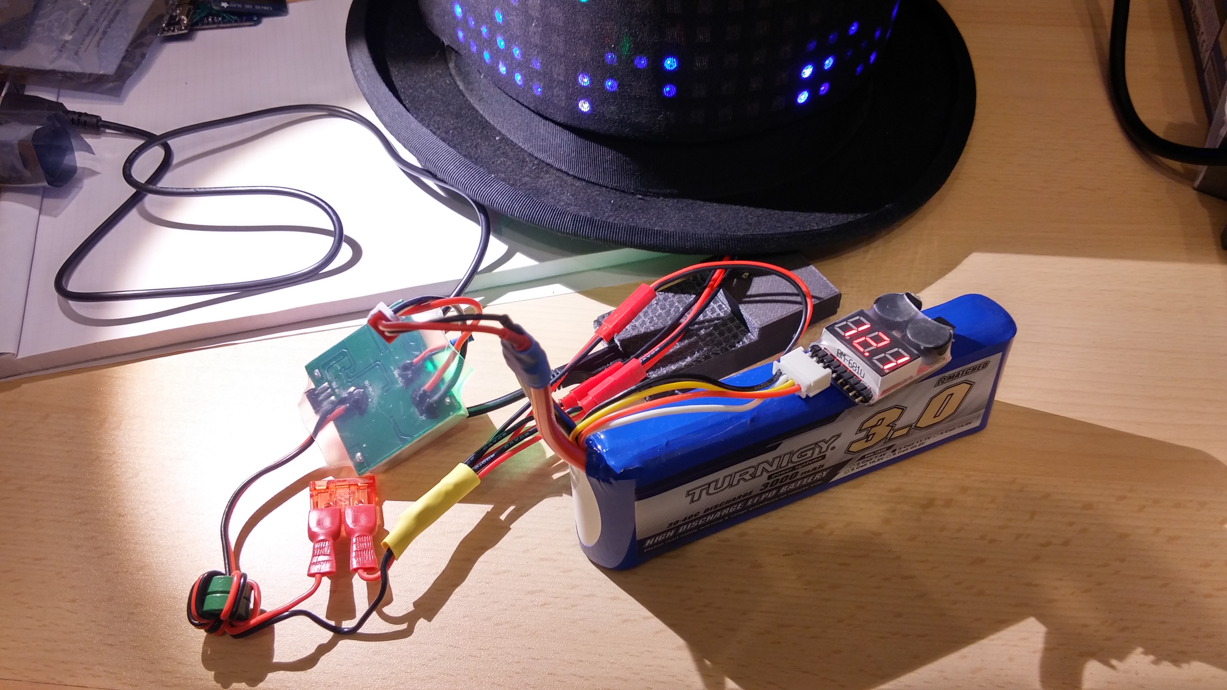

What I’ve learned the past few months using LiPo batteries and a UBEC voltage regulator with a LED hat project
  1. Have a fuse between the UBEC and your power hungry LEDs. I broke my first UBEC by uploading the wrong sketch that displayed full-white on all LEDs. After 3 seconds the lights stayed off forever :frowning:
  2. Have a battery alarm connected. I broke one battery by leaving it attached to the hat over night. The battery pack looked like it had been stung by a bee in the morning.
  3. Turn the brightness down. The battery lasts longer this way. 488 LEDs at brightness 32 (1/8th) last 7-8 hours with a 3-cell, 3000mAh battery.
  4. Think of the extra weight you put on your head. The battery alone weighs around 300 grams, I noticed my neck straining after the second day of wearing it on an open air music festival.
  5. The hat and battery are extremely sturdy and survived rain, heat and even the mosh-pit at several concerts without any problems.
