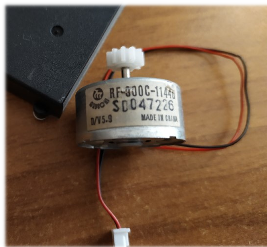

these are my first experiments with Arduino, I’d like to use this engine:
But I don’t know what kind of engine is and if I can control its speed.
Is it possible according to you?
Is it a DC engine?
Thank you very much
Claudio
Since it only has 2 wires, a red and a black, I would assume it is a DC motor. I would try googling the model number and see if you can find a spec sheet for it to be sure.
Here is the info on the motor.
http://www.motors.wrobots.com/RF-300C-11440.php
Thank you very much, I can’t readd the 300 on the motor.
However yes I think it’s it.

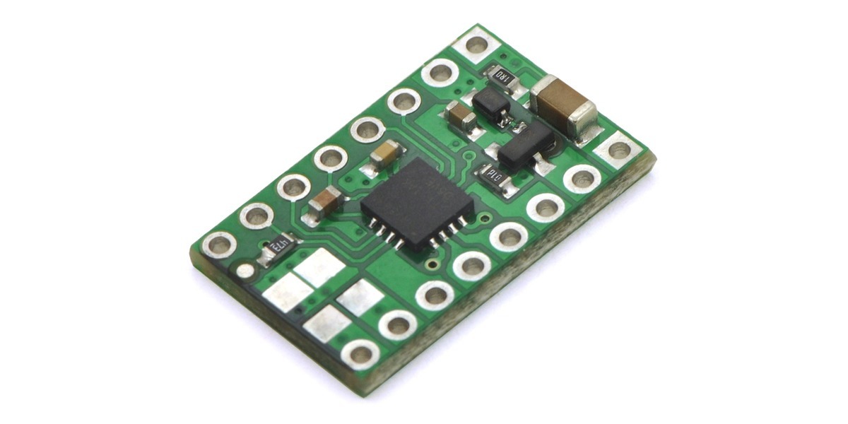

A motor driver like this or similiar could be used:
