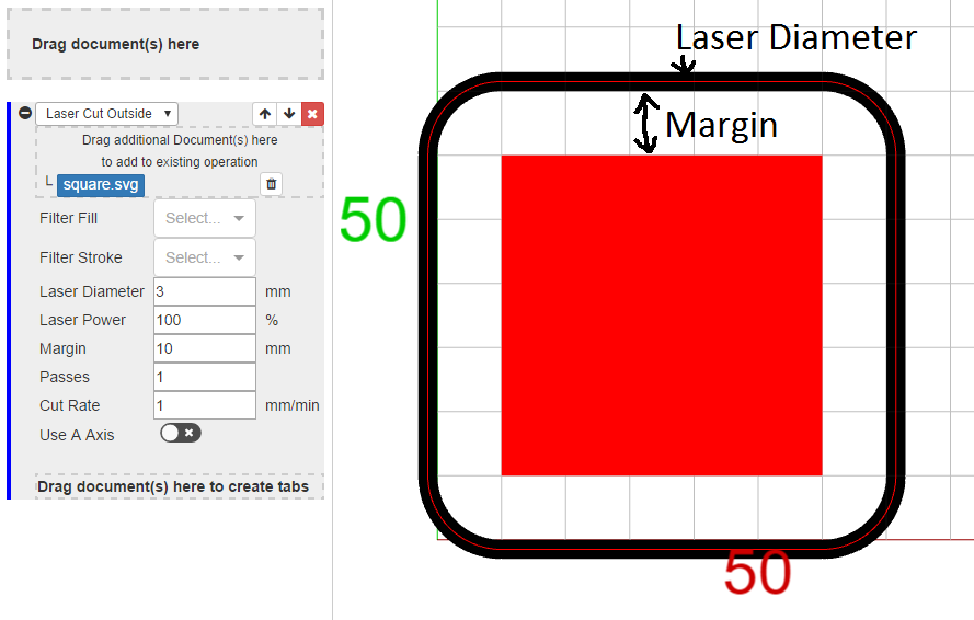

What Margin does

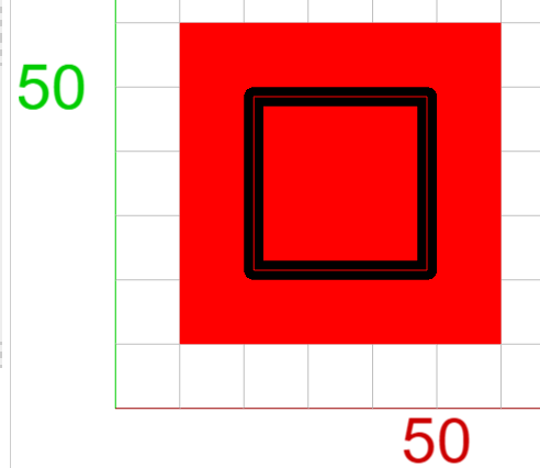

Laser Cut Inside (Margin=10):
@Todd_Fleming that’s a minus 10?
That’s a positive 10. The direction that Laser Diameter and Margin offset depend on the operation. Outside goes out, Inside goes in. Both operations support negative Margin, but not negative Laser Diameter.
My bad did not see it was outside operation
