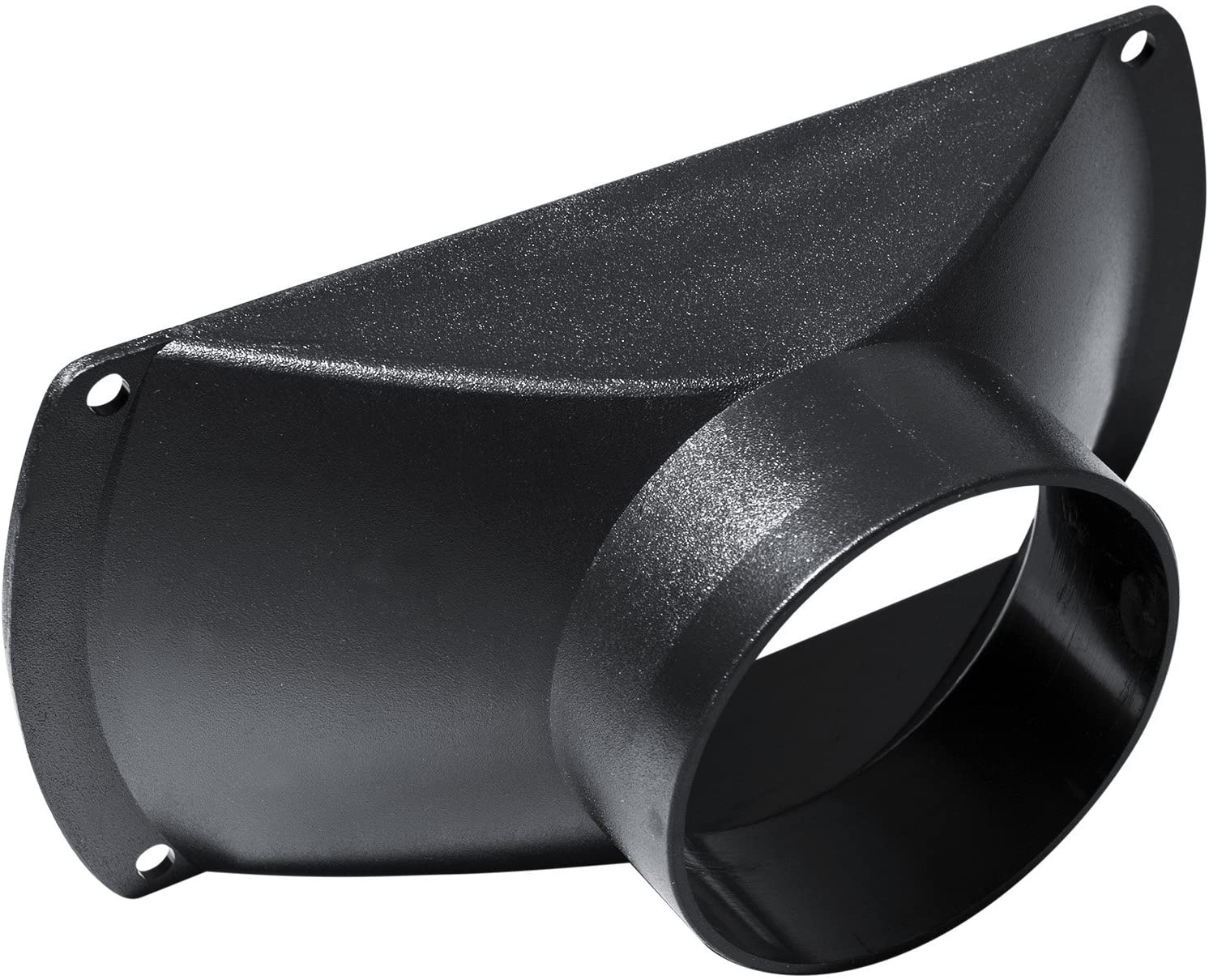

What part are people using for the exhaust port in rear of machine? I have seen links to a part on Amazon but I can not find it now

@Ulf_Stahmer Thanks, but I am looking for the part that attaches onto the back of the machine in the slots like the stock POS fan does. Not the actual fan itself
None, I just removed the exhaust port & put the fan back where it was. Probably not ideal, but I will sort something better when I get around to it.
Oh, I remember seeing something someone posted about buying a flange at HomeDepot. I made my own for a few dollars out of a 3-1/4" x 10" duct takeoff and some spare plywood. I posted the photos here. Search on “exhaust” to see them.
I bought this. Was cheap and said to fit perfectly.
Yes. That’s the one I saw posted. Hope it works for you!
I bought the 4" bilge blower, ~250cfm and a 4" flex hose. Pinched that directly into the opening on the rear and liberal use of the aluminum (real) duct tape.

@Greg_Curtis_pSyONiDe I bought a 6". It was cheaper than most 4" ones so I am going to use a 6"-4" reducer. Yes, I was going to put the fan on the end of the tube opposite of the exhaust port of the machine.
http://www.ebay.com/itm/172203049670?_trksid=p2057872.m2749.l2649&ssPageName=STRK%3AMEBIDX%3AIT
I used a floor register vent something like this: http://www.lowes.com/pd_36418-85334-GVL0084___?productId=3134369&pl=1&Ntt=floor+register+box
