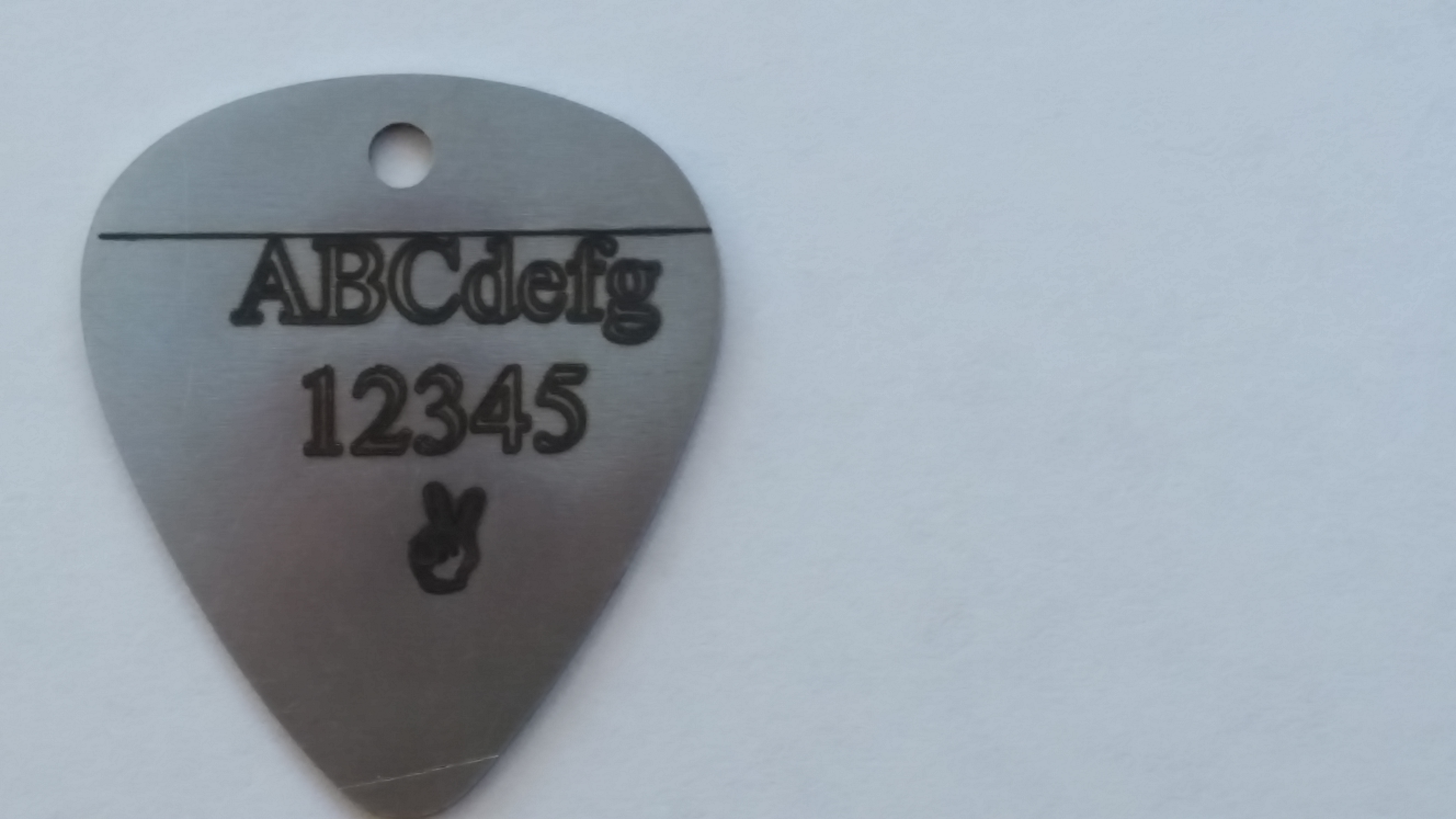

Last week a machine shop asked me to engrave part numbers on some 300 small 304 Stainless Steel parts they were making for a customer. I had not tried to do this in stainless yet so I suggested doing a few sample parts and then if the customer liked them I would go ahead with the rest. They sign off on them and I ran the rest.
Unfortunately I can’t show you a picture of the part because it is a proprietary design… but I do have a picture of a test piece of material with some engraving on it.

The laser power settings were not high, I think I used about 12ma. And I was cycling about three a minute. I charged 35 cents each. Total time doing them about 2 hrs. and made just about a $100 profit as I only used about third of the can of Moly spray. Acetone, about a cups worth. I was able to wash three as it engraved three stacked side by side.
Thanks, how permanent is this marking. Call it engraving but you’re not actually cutting into the surface of the metal are you? It seems more like painting or powder coating to make it stick. Will this work for any metal I’m interested in brass
I don’t know for sure but I was unable to scrap it off with a exacto blade. Looking at it under the microscope appears to actually bond with the stainless and is kind of like ceramic. The parts I made appear as indistructable as the stainless surface.
