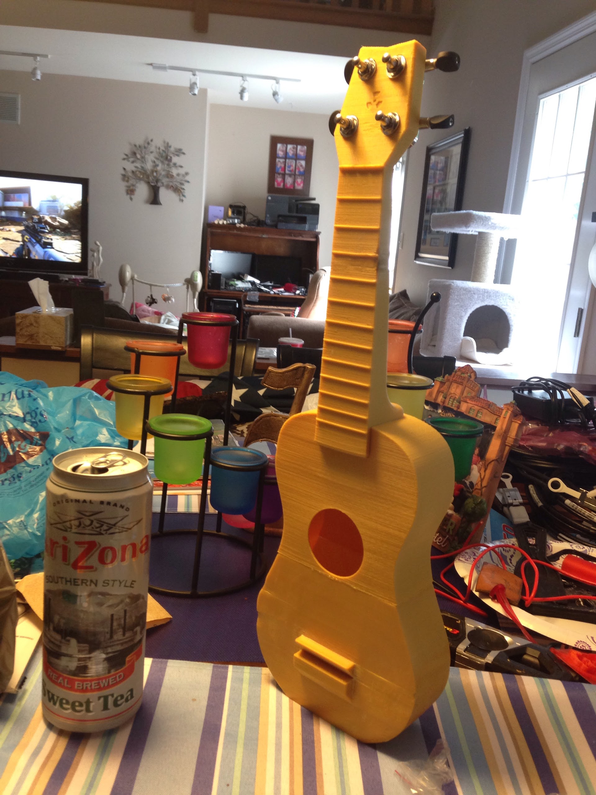

What product do you guys use to get a good smooth finish on your prints? Tried just sanding the ukulele but it didn’t work too well… Thinking of more of a product that you put on and then sand

I’m actually using bondo and then sanding it smooth, priming, painting, and putting a matte finish on it
I will post again with pictures when I’m finished
