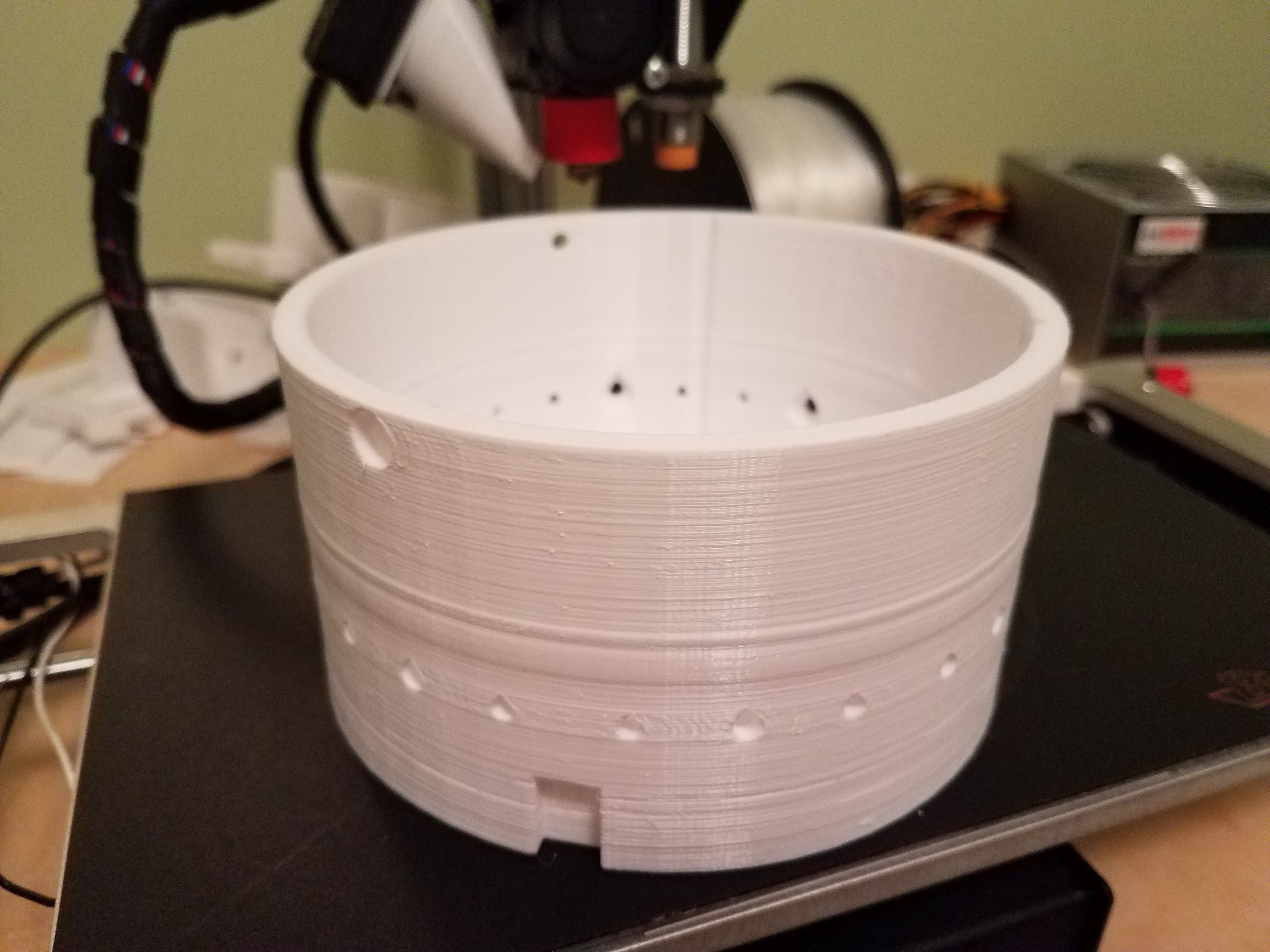

What seems to be the problem here? I think it might be inconsistent filament diameter but I thought I’d ask the community before I write off the manufacturer and ask for a refund or replacement. Esun PETG. The last two pics are of the problems I mentioned in my last post, the gap before extrusion due improperly re-priming after retraction(which only seems to occur on the layers with more surface area), and the small blobs above the rings due to pausing before layer changes. Any help is much appreciated.

Seems like a filament inconsistency to me.
No digital caliper to check the filament diameter? I’d definitely suggest getting a pair, you can get decent ones for ~$10.
That said, I’ve always had trouble getting good cylinders on the PSM myself…
What’s the layer height and speed?
Filament inconsistency isn’t unusual on eSun. I’ve gotten upwards of ±0.10 on some rolls.

@Tom_Nardi I do have a caliper and that was the first thing I checked but I’m seeing between 1.72 and 1.76 along the portion that I measured but this was a nearly 10 hour print using more than 54 m of filament and most of the print is fine so I would have to unroll it too much to find this sort of inconsistency. Layer height is 0.2 mm and default print speed is 60 mm/s but perimeters were printed at 45 mm/s. I checked the belt tension on my X and Y axis right before the print and then after once I saw the defect. I also calibrated my extruder before as well.

I had some PETG that required speeds to be very low, but it looked beautiful when printed at 15-20mm/s. May try lowering speeds and see if that helps any. ^^
@Kura_kuea It’s only bad on that one section, if print speeds were the problem it would be shown over the entire model.
@Adam_Steinmark does the poor quality only happens in some areas of the model? It’s less likely to be the filament then.
If it’s mainly happening on long straight sections or sweeping corners, that’s where head speed will actually reach maximum. So it could be speed related.
@David_McGuigan No, the print is identical for each layer after this until the veritical holes at the top.
Which do you print first, the external perimeter or internal?
What temps are you trying to extrude? What are your general speed settings? I’d do no less than 230°C and outermost perimeters no faster than 45mm/s, but be willing to test slower and/or hotter.

Maybe the print bed is slipping
@Kura_kuea internal
@Jeff_DeMaagd 245 C. 60 mm/s base speed, 45 mm/s for the perimeters.
@adrian_nicholson If you look up you’ll see I mentioned that I checked my belt tension before and after the print. I found the method of securing the belts with zip ties was not reliable enough, so my belts are held by plastic clips with a zip tie to prevent vibration slowly pushing them off. Those babies aren’t going anywhere. My X belt is also only about a month old. Besides there was no layer shift, just bulge.
I had similar issues, spoke to the manufacturer of my printer. And was told that the print maybe be slipping. Does the print bed move when printing or is it stationery? Mine moves back and forth.
@adrian_nicholson yes it moves in the X direction. This is the Printrbot Simple Metal with some upgrades including the upgraded bed if that helps. It’s possible the bed could slip but the way I have rigged it makes that possibility very low but I checked for slippage and there was none. If there was slip there would be layer shifting which is not seen.
