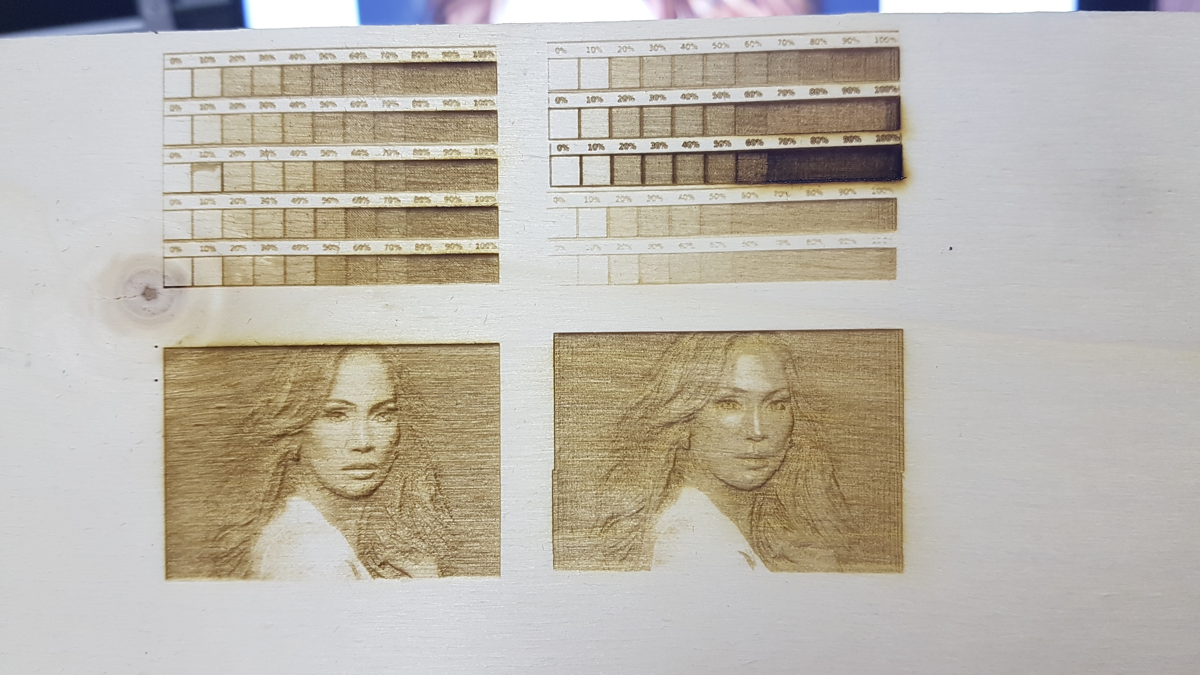

I will say that the first bottom to top from the right is very good, darker is not seen but surely is deep. That changes with the material
I tend to run @300mm/s 200usec pulse duration and vary from 0-50%, 0-75%, and 0-100% depending on substrate and desired depth. Pot set at 10-12ma. 200 usec seems to have a more even gradient than 20 and 400 didn’t change much.

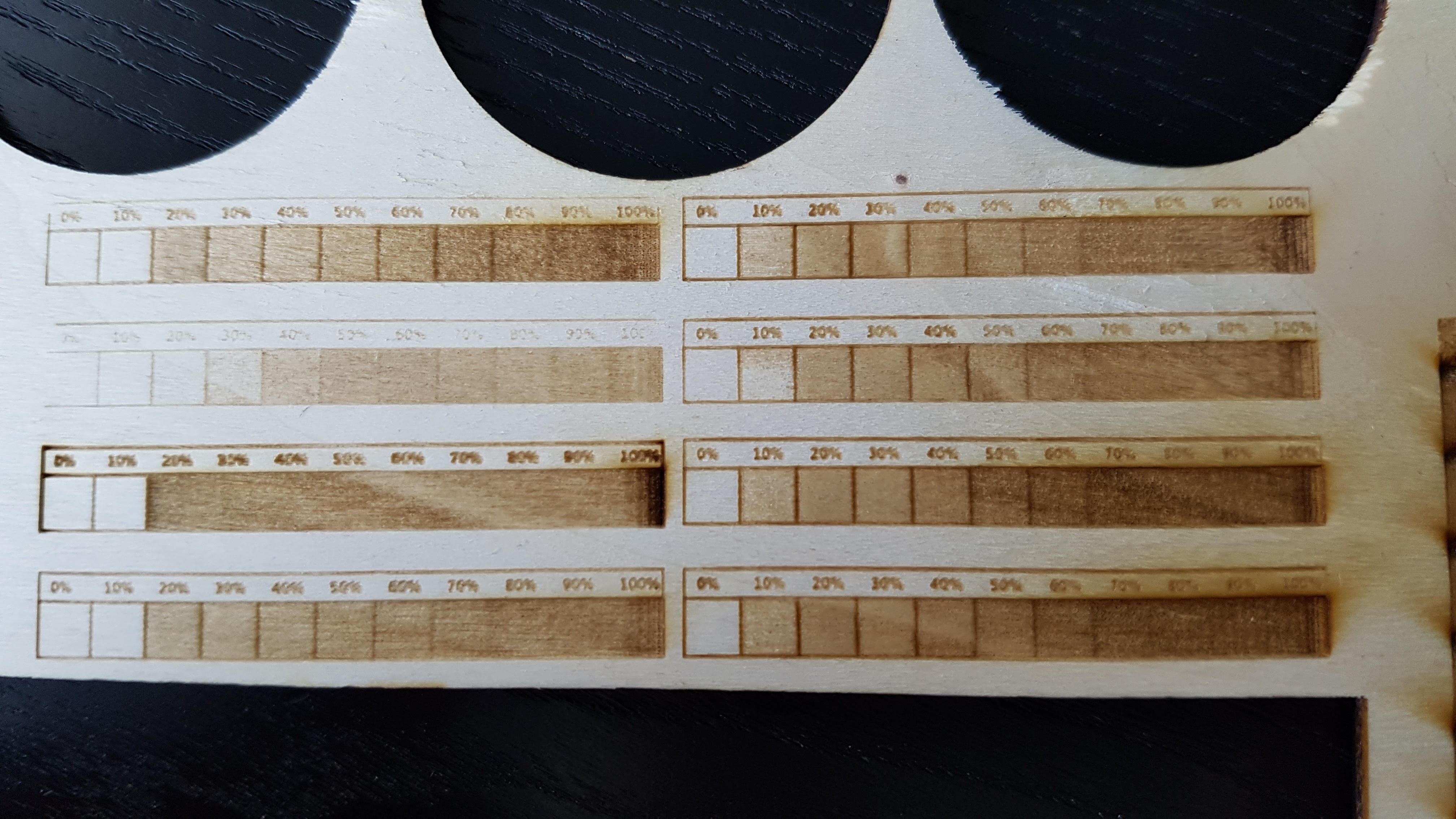

Are the patterns in the pict above all run at different times and settings? Do you have a pot installed?
Because I was not able to set the current lower than about 3-4mA with the pot, I had to generate the gcode with only 0-10% power at 100mm/s. With that same gcode i have run the job several times with different PWM periods between 20 and 300us. Shorter periods get deeper burns, but not darker. The right column was with 200us. Then I played with the feed. But I am not satisfied yet.
It looks like I have too much power, but if I go faster, it gets deeper, but not as dark.
+Peter van der Walt I did also test with LW3 and different feeds for black and white, but the difference was not much.
A am not satisfied yet, because it looks like I got better grayscale with the moshi board. Will test furter…

The grayscales on the left (moshi) was all made with the same default settings (1000dpi, 100mm/s, minimal current), on the right I tried to reach the same result with LW4 (same current, 200us PWM period). From bottom to top:
- 100mm/s, 0-100%, 0.2mm laser diameter
- 100mm/s, 0-100%, 0.1mm laser diameter
- 100mm/s, 0-100%, 0.0254mm laser diameter (=1000dpi)
- 100mm/s, 0-100%, 0.05mm laser diameter
- 80mm/s, 0-70%, 0.1mm laser diameter
The left picture was made with 1000dpi, 100mm/s, the right with 80mm/s, 0-70%, 0.1mm laser diameter.
