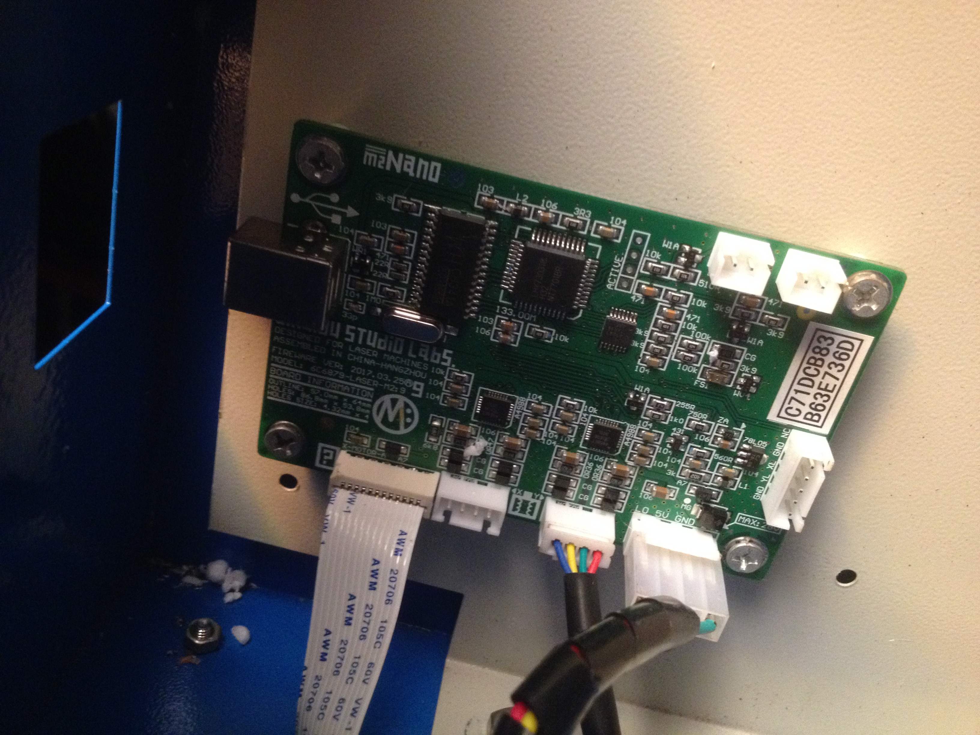

What should I pick for my laser controller model in laser drw settings? I have a Nano 2016G Nano or KETAI GOLD 5. That is the only model # I can find. I have been using the B1 selection but it really seems slow. It auto finds the right s/n and the b1 is what it uses. Any help would be great
I would guess M2. The ‘2016’ implies it is relatively recent and M2 is the highest rev and most common.
Thanks for getting back Ben, your link is bad. Here is mine
I’ll try M2, thanks scorch works
Yeah! Gz!
Cant figure out how to post pic here, did you see the pic I sent you Ben
Sorry to tell but it seems this is not the same board as i have. May some other guy can told you more.
Well tried them all. Only B1 seems to work (sort of) It is very slow though
Wow, I am shocked by that. I was confident M2 would work. Thanks for the update.
