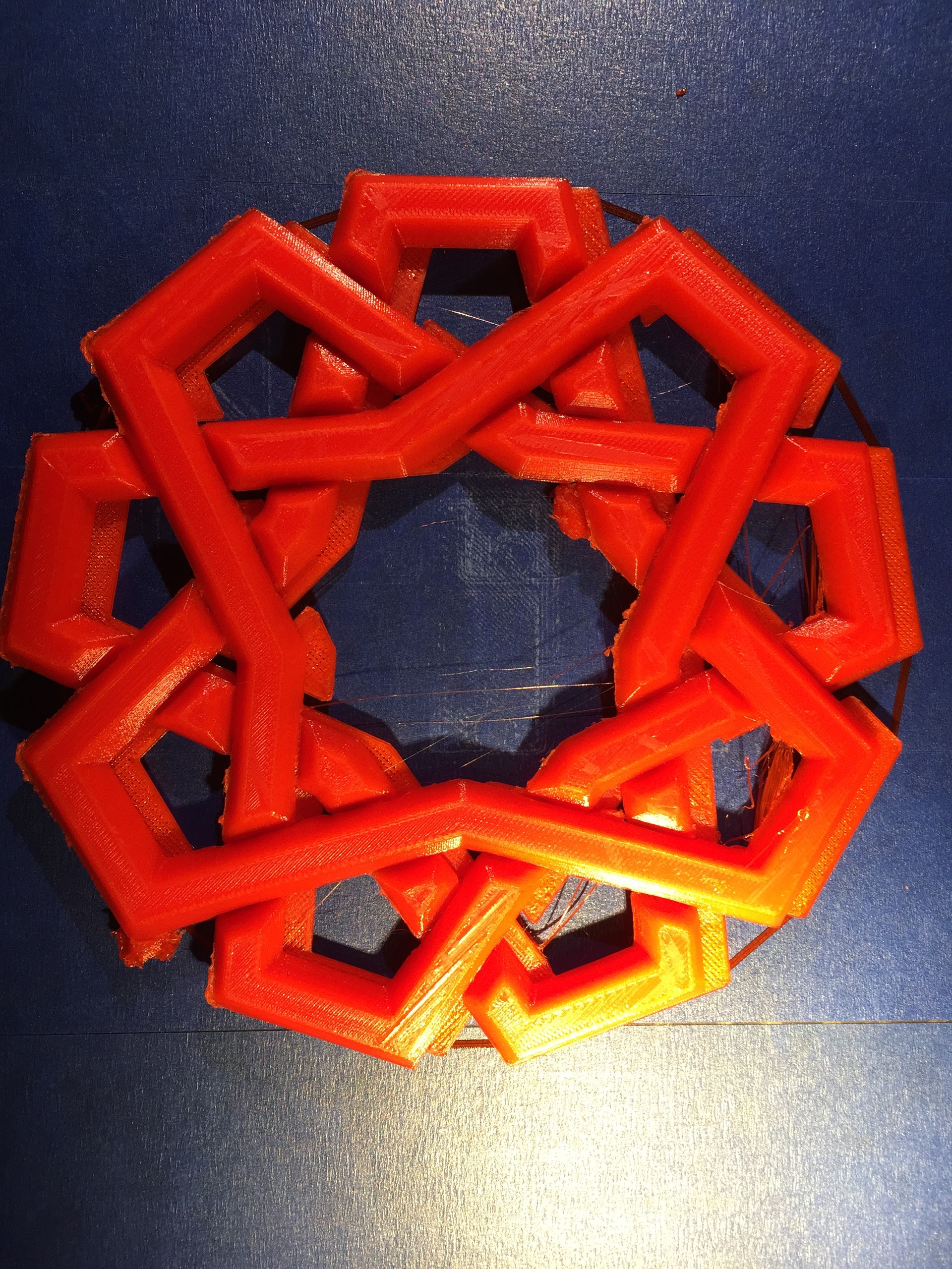

What the bleep?
What the bleep?
One of your axis motors skipped. You can slow things down a little bit, or turn just travel moves down, there are a couple of different solutions to this. Nozzle could have hit a curl and bounced over it, so cooling would solve that issue, etc.
It looks like right now I have auto cooling enabled. Should I just run the fan all the time at a certain speed? I noticed this issue where it was getting caught on another print job. All the pieces were shifted like above.
This is a brand new extruder.

It looks like the pieces were peeling off and getting caught causing the belt to slip. I cleaned the plate really well and I’m starting the job again. The first time I ever printed this, it printed flawlessly.

Looks like it will finish printing this time. About another 3 hours to go. :slight_smile:
