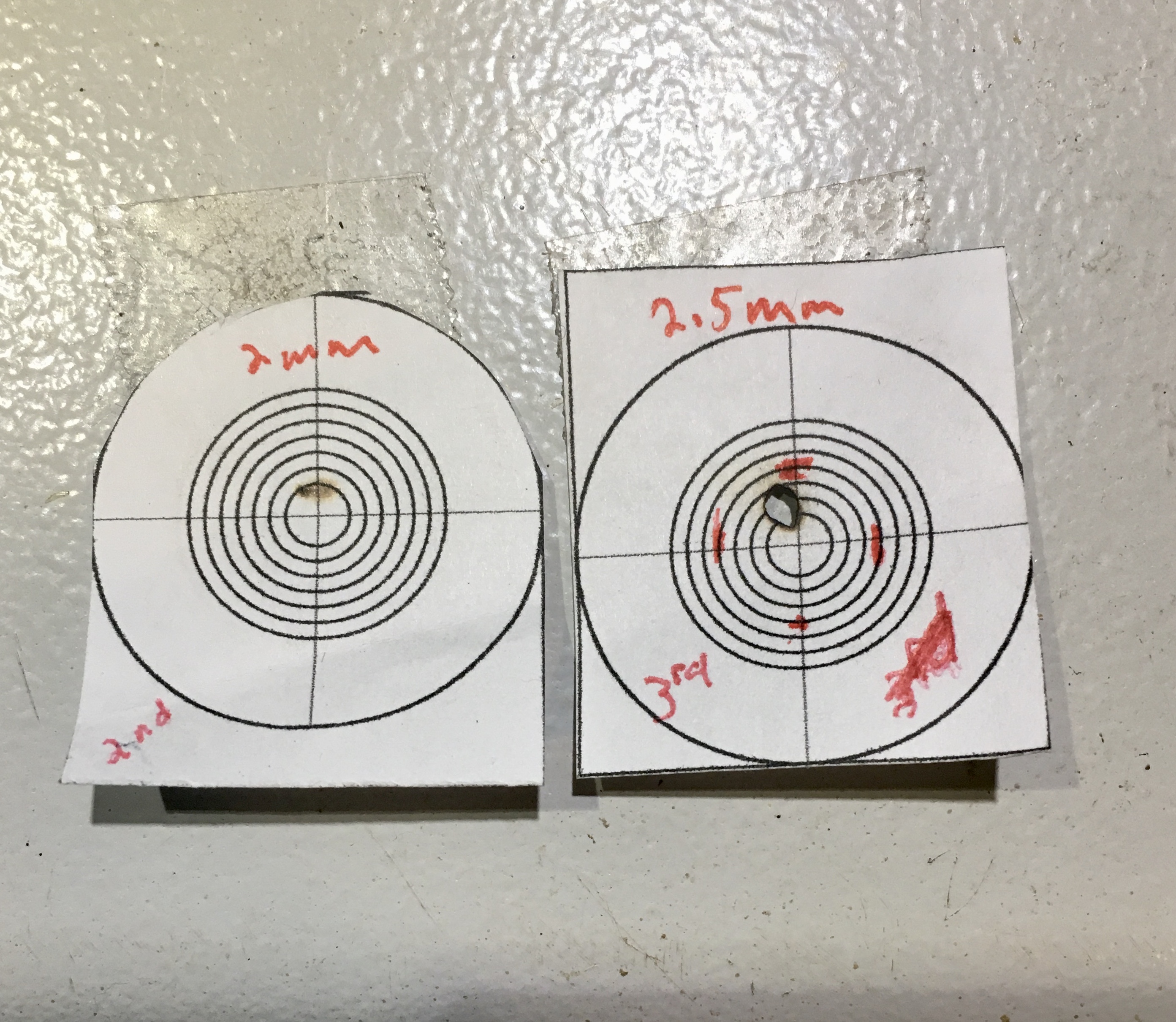

Alignment on the 2nd and 3rd mirrors were both out just a bit. Weird since the alignment between 1st and 2nd mirror almost never changes. Fine, realigned everything but noticed the spots for the 2nd and 3rd mirrors were both a bit high, 2-3mm. Historically I always have had these 2 mirrors pretty much centered on the beam.
The higher spot is not an issue for the 2nd mirror since there is still plenty of mirror surface to reflect the full beam. However, for the 3rd mirror, the opening into the laser head is only 10mm in diameter. So the beam is now hitting close to the edge and likely not transmitting the full beam.
Something obviously changed before the 2nd mirror. Check the first mirror and it was spot on (can’t remember if it was historically spot on because I haven’t checked since I installed the tube). So what the hell happened? Obviously something shifted, but what, the tube?
So I decided the easy thing to do was to shim the right side of the tube up just a bit so the beam would hit the mirrors lower. Shimmed it with a strip of thin craft foam. Also decided to do a full water change out, because why not, I’m all ready pulling the damn table out to get behind the laser. :roll_eyes:
Checked alignment on all mirrors. First mirror was a bit low as expected and is fine. 2nd mirror was also slightly low, but acceptable. The 3rd mirror was also a bit low, but the mirror carriage plate had thin washer shims from when I very originally set up my machine. So I removed those and it’s now spot on. The 2nd mirror also has shims, so I can remove those at a later time to center up the beam, just didn’t want to deal with that hassle today.

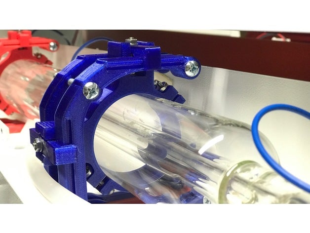

Now that I have a 3d printer one of the thing I want to print are adjustable tube brackets like these so I can get a good solid tube alignment.
Aligning the laser tube/mirrors is a task I’ll have to do soon - once I get the wiring done.

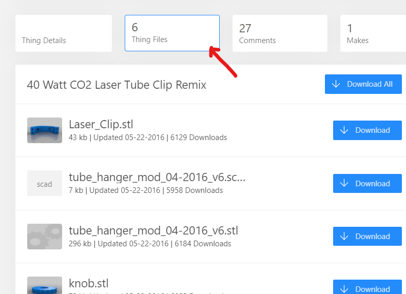

I was excited to see the nice adjustable mounts shown but after wading thru the various links and posts I see there are no design or STL files mentioned. Am I missing something?
If you are refering to the thingiverse link above, you have to click on the the “Thing Files”
There is also another design that I’m considering.
One of the members of our Maker group has just printed this set of mounts for our K40 (my 3d printer is undergoing an upgrade)
Looks like it will do the job. One change was required and that was to modify it for metric fasteners. The inner diameter is 50mm (same as the tube) but perhaps could be a few mm bigger to allow for some padding.
