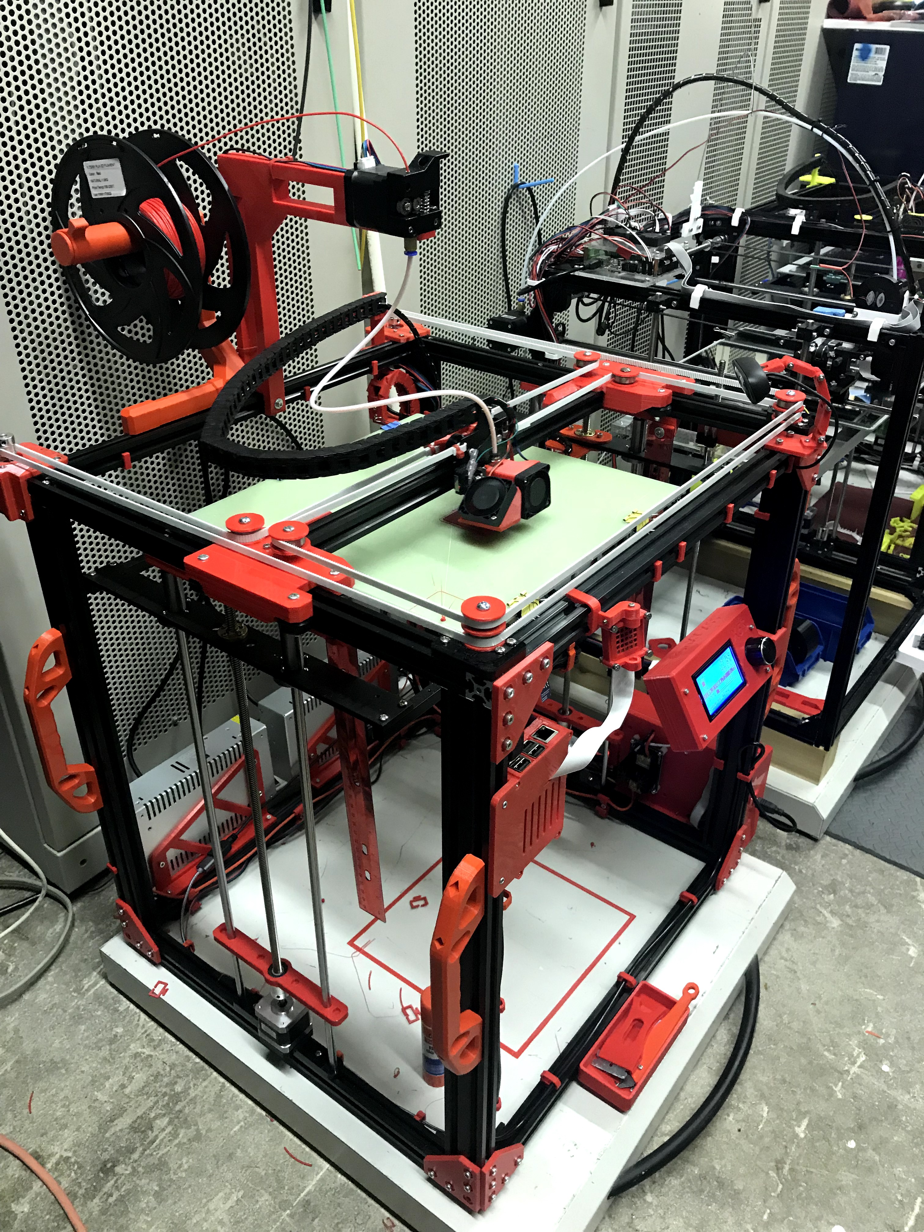

This printer is using steel plus aluminum plate and 4mm sheet and has no problem.
.9 degree however the other 3 in the pic are using 1.8 degree 17’s.

Nice printer. I have a single standard nema17 using belts and three lead screws. The lead screws are 600mm single start 2mm pitch. The bed frame is 2020 t-slot with a 520mm x 530mm x 3mm aluminum (7075) plate on it. It works beautifully. I needed to reduce the acceleration to prevent skipping but that gives it a very cool slow start and then it gets up to speed as it climbs.
