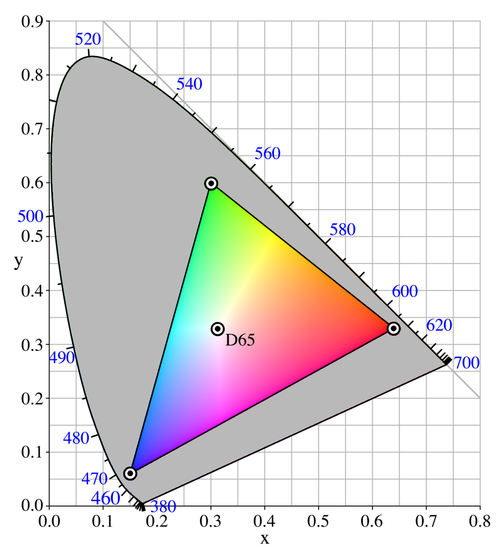

I have a hunch that the codewelt article is focused on the RGBW color space for graphics/photography, not specifically for LEDs. This article is focused on LEDs, maybe there’s some useful info:
Oh believe me, I know a few ways to do the math-- but that’s the issue: there are several ways and they all are for different purposes, which I why I keep coming back to the main question: what application(s) is it specifically going to be used for? That will then lead to answers on what sort of color space you want to define and work in.
For ME, I mostly think it’ll still be RGB or W. Maybe I’ll do some HSV->RGBW, but even that is kinda sketchy without know what it’s going to be used for, and what the goals are.

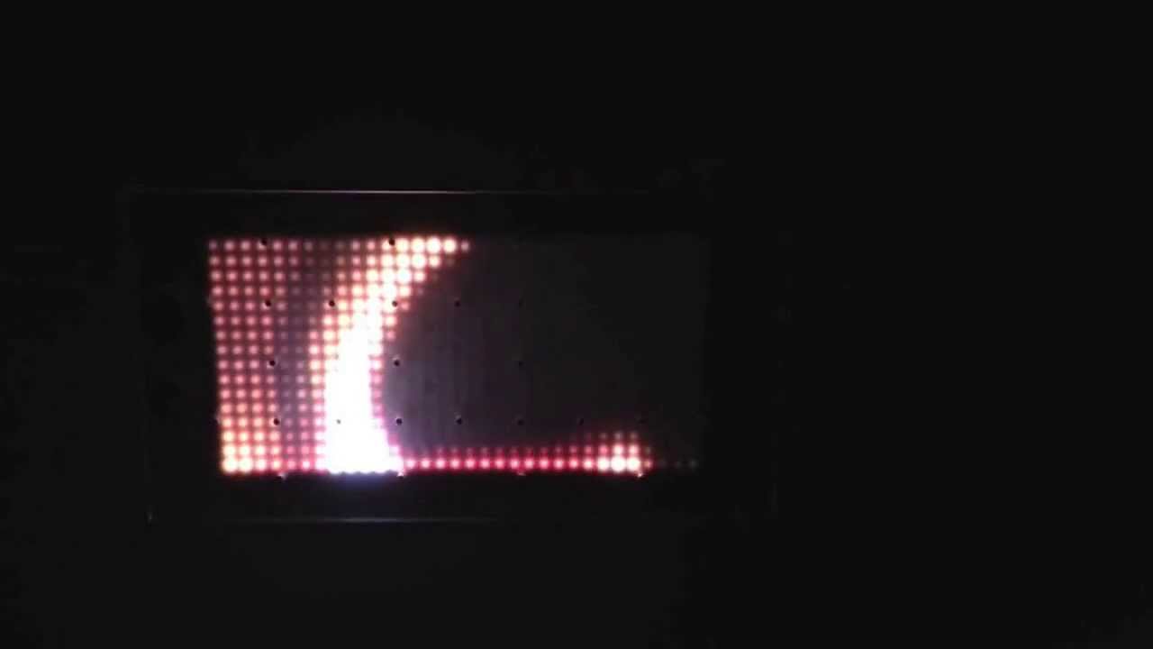

Here’s my use case: a matrix of RGBW pixels on the wall, bright enough to be used as a light source but also allowing for subtle color changes. I don’t believe RGB pixels would work well for this as I’ve always noticed color differences between the pixels when displaying the same white color across many pixels.
I don’t have any code or a demo video for this right now, it’s just an idea. It’s probably going to be similar to the Fadecandy example “Rings Lamp”:
Demo of Fadecandy “Rings” (not “Rings Lamp”):
In my case I want seamless transitions from displaying full white, to a pattern, so I don’t want to display just RGB or W. I expect I’d want the white LED to turn on with no RGB LEDs on when in full white, to get better white color consistency across the matrix. I think I’ll want a conversion function to generate the RGBW colors, and not to try to manage the W channel separately.
