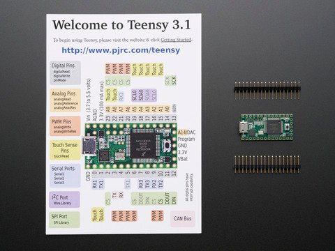

Adafruit has a neat project using an ARM M4 they build that sort of does exactly this. Basically, you need a bit more power than an Arduino can give you to do audio work. However, there are cheap boards that can.
Check out the Teensy 3.1 board and the Audio Adapter for it: https://www.pjrc.com/store/teensy3_audio.html
I’m currently using a Teensy 3.1 and the audio adapter for an LED matrix. I can upload my code for you if you’d like. It’s a bit messy due to constantly being worked on, but it works.
