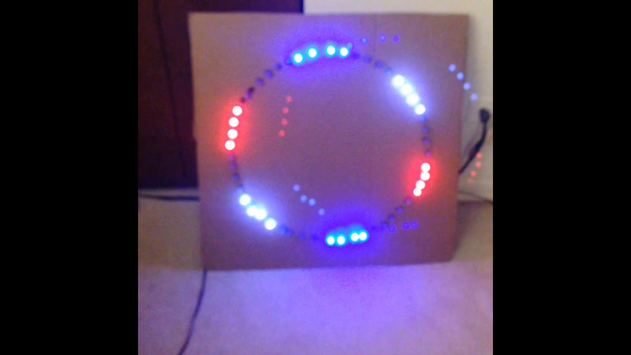

@Trey_Coursey - My cd77_police_lights_all function in my CD77_Police_lights sketch at:
which is on YouTube at:
can be used to do what you want to do. Use the sketch as is but modify one of the color arrays or one of the palettes and modify the time performance code to do what you want to do. You can also just use a modified version of that cd77_police_lights_all function in your own sketch.
