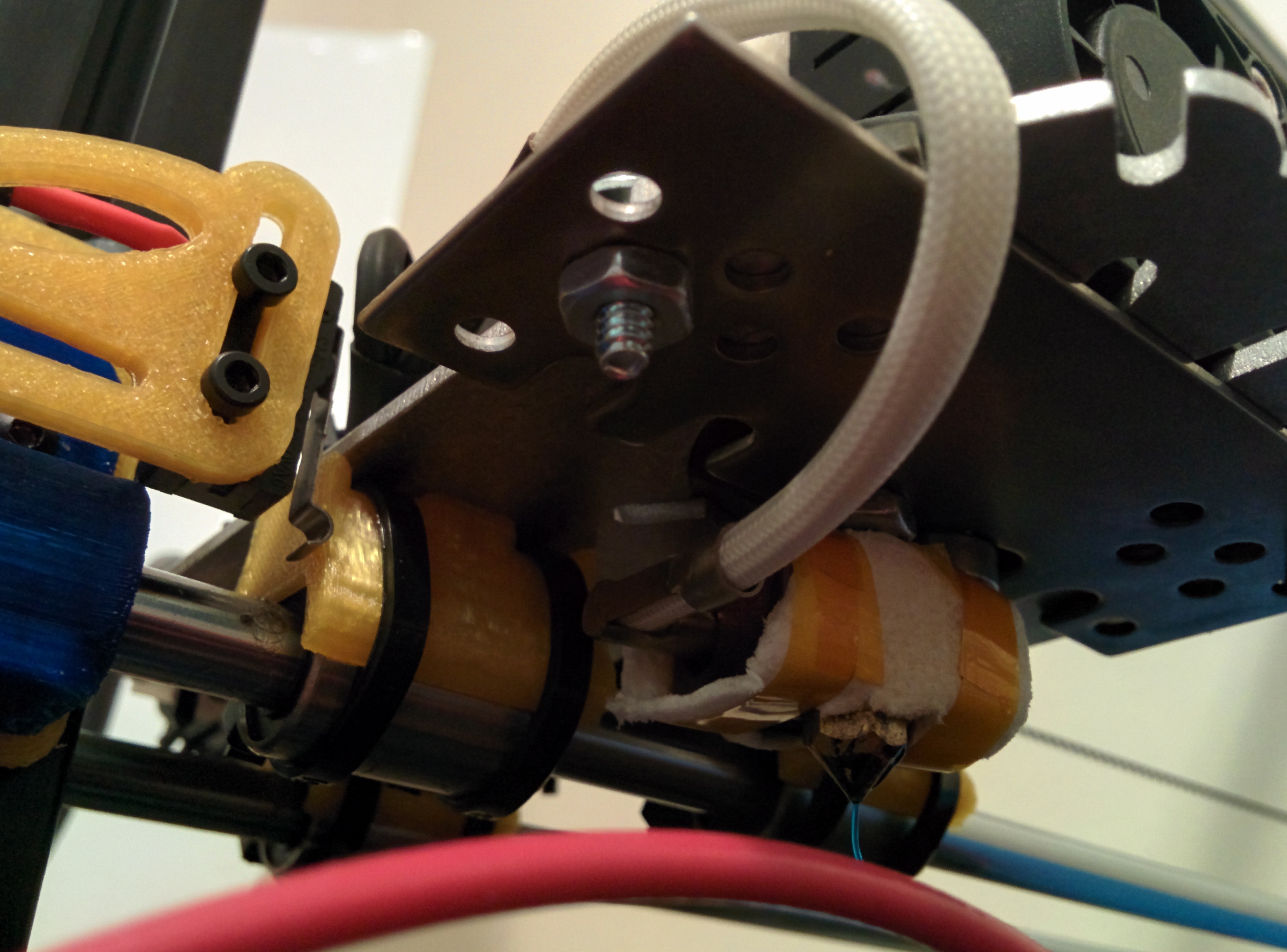

What's an affordable (but accurate) way to remotely test the temperature of this extruder?
What’s an affordable (but accurate) way to remotely test the temperature of this extruder? I want to see how exaggerated this inaccurate Marlin thermistor table is for a QUBD hotend.

Just to update everyone on this, I got leaking after switching to a honeywell. I installed a new 1.75 barrel/nozzle and that instantly worked like a charm. We are getting reliable extrusion, with no x/y issues (so far) on the larger 9" build platform that can later be expanded to 12".
The problem boiled down to shotty build quality from QUBD. I swapped nearly everything to get that thing working so lesson learned about their hotends. All I kept were the motor, fan, grill and mounting block.
