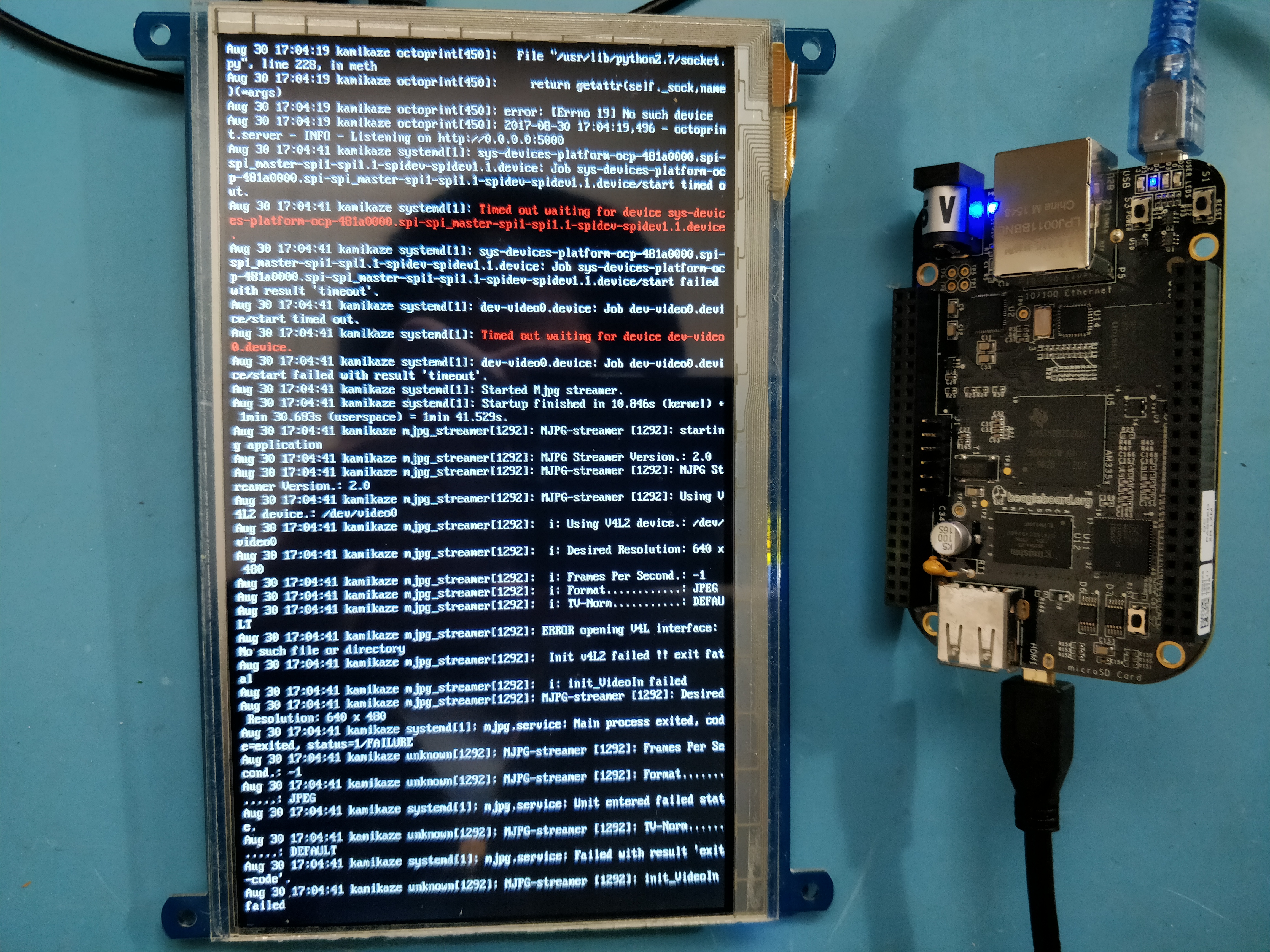

What’s going on here? Just flashed umikaze 2.1.1. I’m completely new to this. I could probably figure it out, I just need a point in the right direction. Thankyou!
The SPI device failure is because the SPI device is the Replicape. Install it on top and that will go away. The video0 error is because it’s looking for a webcam. The Webcam issue is not a blocking problem, but the SPI device will be problematic.
As for why you’re seeing this instead of Toggle, it’s because in 2.1.1 Toggle is known to have a memory leak - meaning it consumes continually more RAM until it crashes the system. We disabled it by default, but it’s still there.
You can re-enable it with “systemctl enable toggle” and it will show at the next boot. Or start it in your current session with “systemctl start toggle” to enable it here. We recommend activating toggle only if you’re not going to be running the printer continuously for more than 24 hours, or it’ll become a problem.
Remember to edit /etc/toggle/local.cfg with the OctoPrint API key and to choose the right theme for your screen (resolution and aspect-ratio).
To make the screen display in landscape mode instead, make sure you disable the console_rotation setting in /etc/toggle/local.cfg (overwrite the rotation setting with a 0) and take out the console or framebuffer rotation from /boot/uEnv.txt for the console to show in landscape mode.
