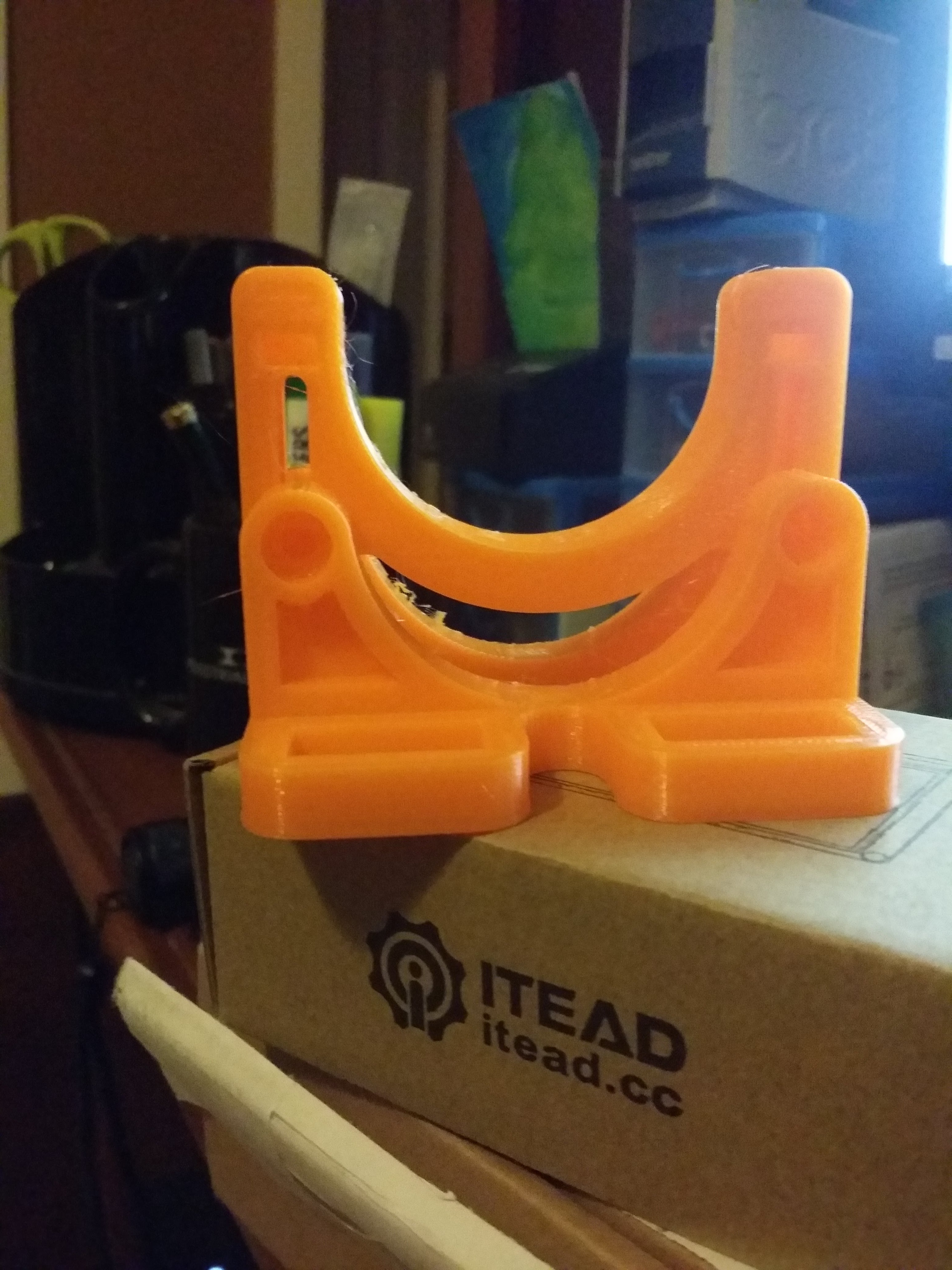

This was the last one that I printed up but never installed due to selling the unit.
That looks nice and simple but knowing how well made these machines are made I wonder how many shims I might need to get the correct hight.
@donkjr I’m just printing the other one @HalfNormal posted but that was the one I was looking at. I guess I’ll just have to try both and see which one fits in my extension tube.

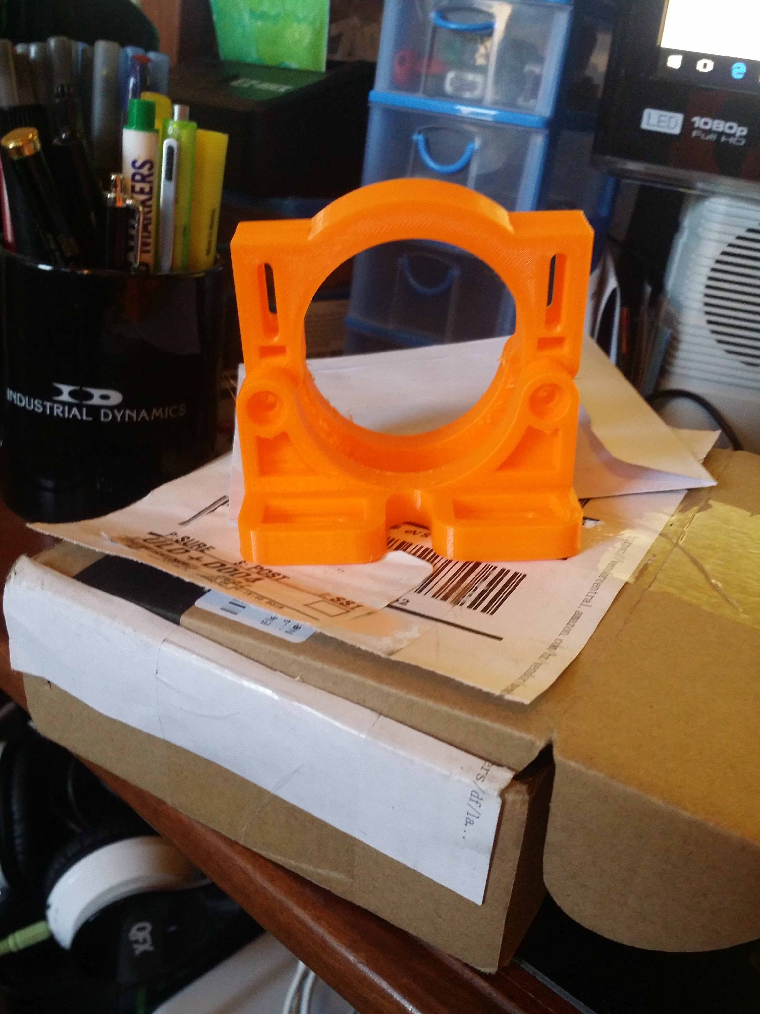

The picture I took of it does not show it correctly. That top piece actually rotates 180 degrees and that is your height adjustment.
@HalfNormal right I get it, left and right but the fixing bolts to the chassis and height but turning that top but upside down. Thanks that’ll do nicely

@Andy_Shilling here is the correct orientation.
@donkjr notice the box?!
@HalfNormal that looks perfect, I’m running it at 40% infill so will take a little while to do but hopefully be ready when the rest of the machine is rewired and new extraction position is sorted.

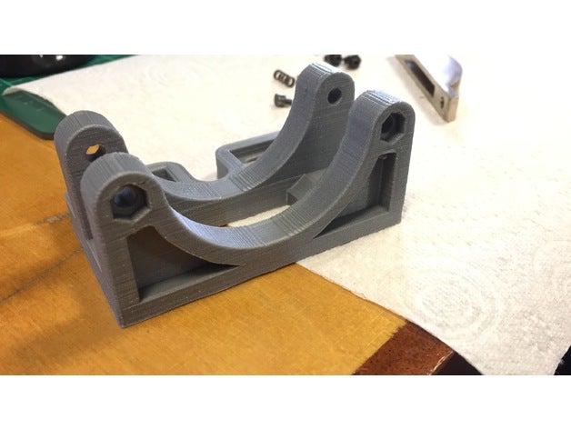

@donkjr
Are you thinking of something like the mount in this video?
@Nigel_Conroy exactly that!
