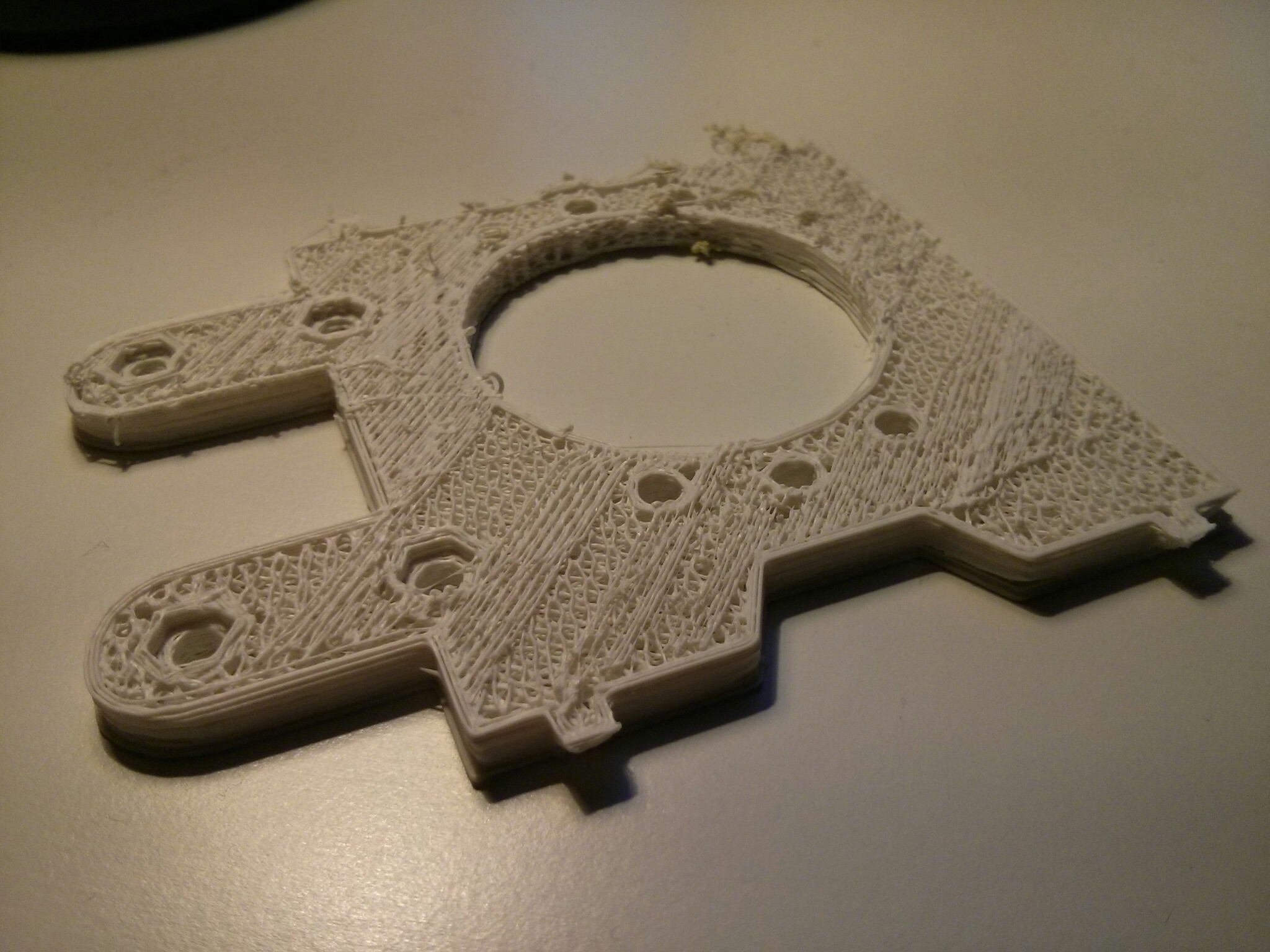

Background: Belt holder on X carriage cracked loose. A dozen rubber bands seem to almost hold things together well enough to print a replacement part. Unfortunately, stripped filament stopped the print halfway through. I’ll try to glue things up and let dry over night.

I’ve used a glue based on methyl acetate and acetone on other parts, but the X carriage just didn’t hold up. More rubber bands and some tightly wound tape seems to be just enough to print a new X carriage, luckily.
